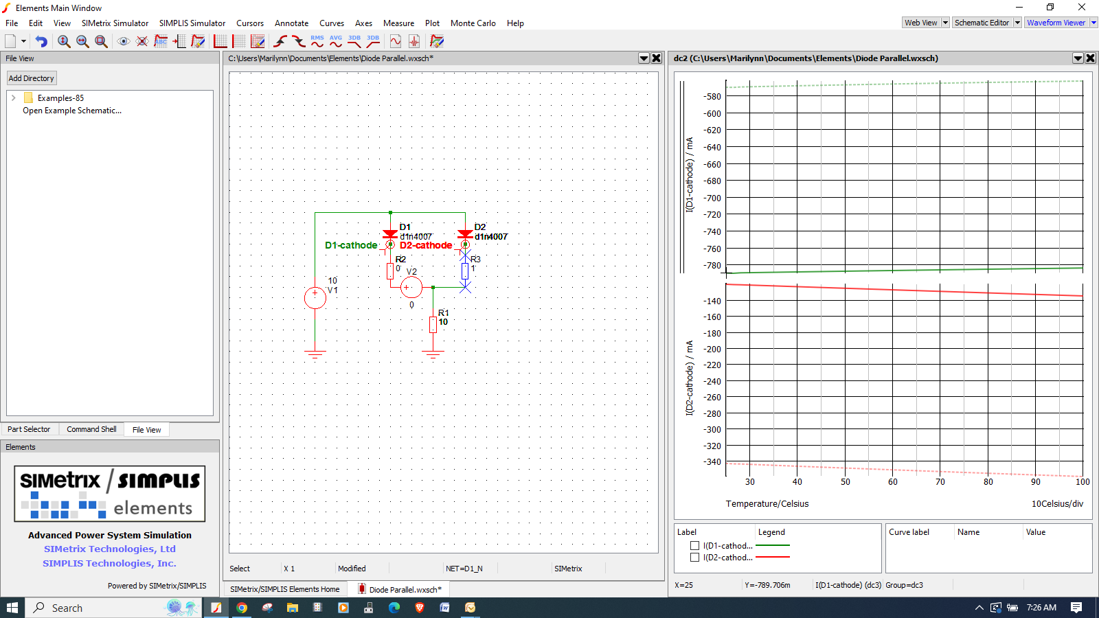

It's interesting that you are looking at this.
I took another look and found that for two parallel diodes using just one resistor in series with the diode that draws the most current, the current can be equalized perfectly. The question remains what happens when the temperature changes. I have a feeling that they go unmatched again, to a significant degree.

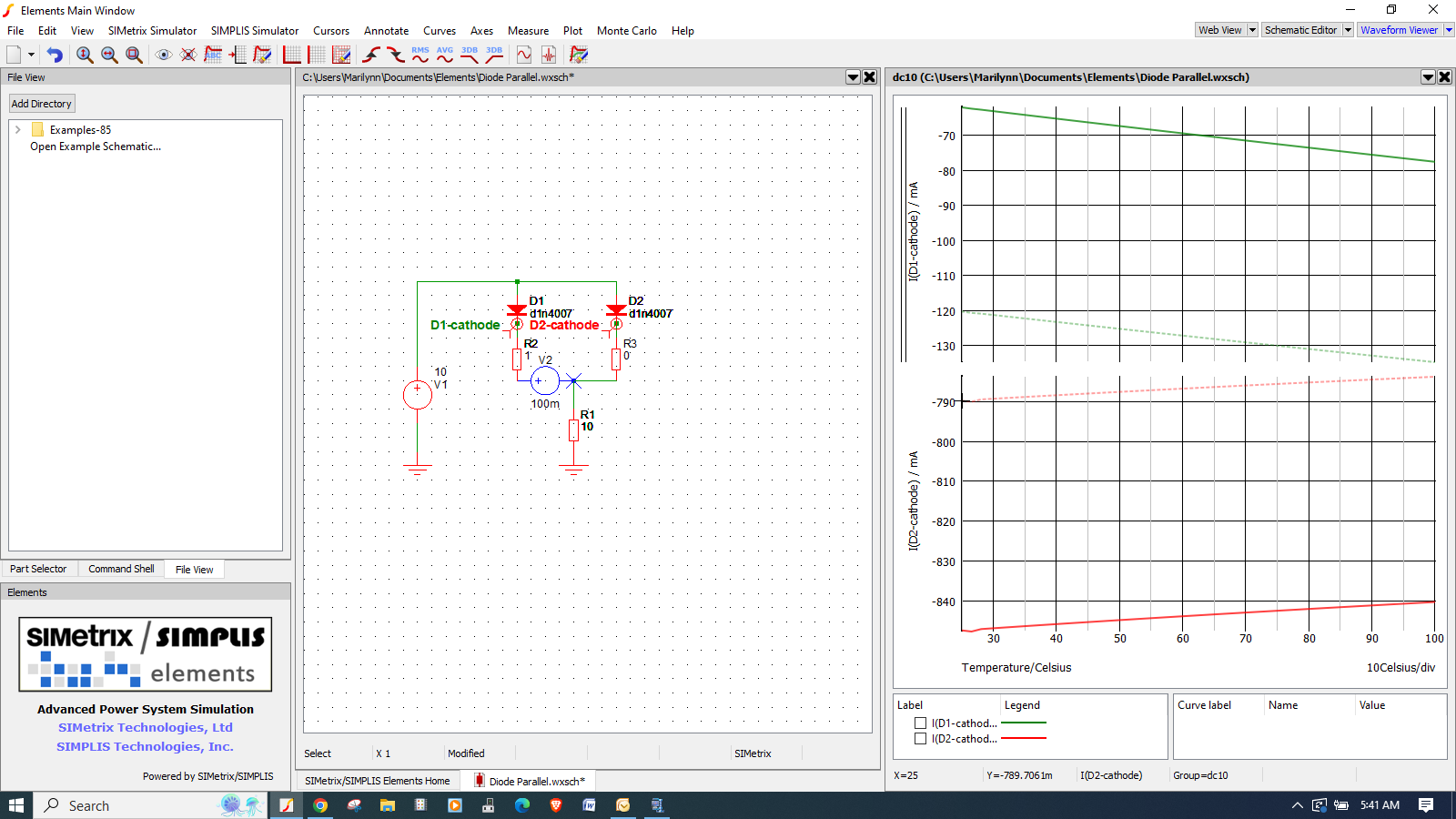

Here, with 100 mV of offset, then 0, in one diode, 1 ohm in one leg :
Still waiting on sim guys to answer a question to get a more exact sim w/o
the artificial diode Vth I put in with fixed V source versus a model Vth change,
which shows no effect.
Regards, Dana.
Regards, Dana.
Well I was thinking more like putting the resistor in series with the diode that originally draws more current. That would be D2 in this drawing.
1 Ohm probably too large though.
Nothing earth shattering yet. Still waiting on sim vendor to reply
to model Vth effect not working as expected.
That being said a fixed .5V offset produces very large difference,
and only get balanced with larger R, say 1 ohm. Keeping in mind
currents all < 1 A
Regards,. Dana.
