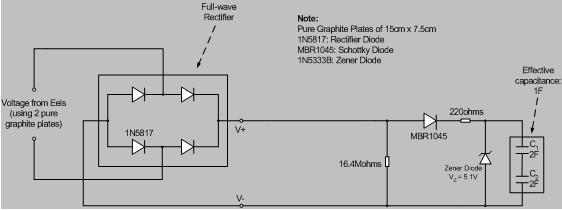

Ok just to give a more detailed idea... i got a series of pulse ranging from 2V up to 50V and the duration of each pulse is about 0.3sec. Btw this pulses are obtained from electric eels ....really. However the current from the eels are very small (in mA).
My main idea is to store them into a energy storage device which i have narrowed down to supercapacitors. However over a duration of about 30hrs, i can only charge up a supercapacitor of 1F by 0.1V. I'm still looking for supercapacitors of smaller capacitance such as 0.5F to try out.
I have tried using a pulse waveform generator to simulate the pulses from the eels. And im able to charge a supercapacitor of 1F by 0.5V in about 2mins. So i guess these supercapacitors are able to charge up with pulses of such duration (ie. 0.3sec)
Attached is a circuit of my charging circuit. The 16.4Mohm is to raise the load impedance so as to maximise the power transfer to the capacitor.
Pls advise me on anything if i did some silly implementations. Thank You!!

Ok, i don't really see a clear question.. but however, i was wondering,
1-why add the 16Mohm R?
2- why use the 5.1 zenner regulator? why not letting the maximum voltage across the capacitors, this could decrease the charge time..(i think)
I thought electric eels give shocks. Only 20V doesn't give a shock.
If all the pulses are 20V at a current of 2mA for a duration of 0.33 seconds for each second, then a 1F capacitor will be charged to 5V in about 66 hrs.
The actual time will be much longer because many pulses are less than 20V, the average current is probably less than 2mA and the duration of the pulses don't appear to be present for 1/3 of the time.
Your test circuit has a current-limiting resistor of only 220 ohms which limits the current to a whopping 80mA. About 8.2k will limit the current to 2mA.

Hi Ibrahim,
The max voltage for some super capacitors is only 2.5V, so he has 2 in series and is using a 5V zener diode to protect them.
The power from the eels is so low that it will take a million years for the capacitors to charge to 5V. Maybe the capacitor's value should be 1uF.

thxs for giving me advice.. just to clarify some doubts being raised.. the 5.1V zener diode is to protect the supercapacitors that i used (which has a rated voltage of 5V)
the 16.4Mohm is to raise the load impedance so as to maximise the voltage being transferred to the capacitors.
reason for not using any op-amp is because i dont want to use any external power supply to power the op-amp.
in literature, the eels may emit voltage up to 600V but due to attentuation, the highest voltage i have acquired so far is 60V.
meanwhile im still trying to get hold of some smaller value supercapacitors so that they can be charged up in a shorter period.
i have also tried MAX1682 voltage doubler which is capable of working up to 12kHz. But the results are not very encouraging as well...
with the components that i used....are any of them being misued which caused power loss of the components?

Maybe that is why the power from the eels is so low. Maybe your circuit needs a step-down transformer.
Even if you do manage to charge a small-value capacitor, what are you going to use the small charge for?

Your eels can't charge 2F, you tried it. They might charge 0.2uF then it can blink an LED for a few milli-seconds, one time per day.
