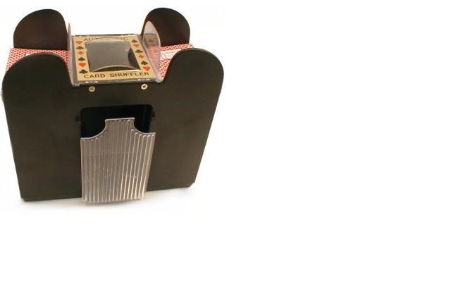

HOw does a card shuffler work? It'd probably be easier to make a tower crane type thing that lifts cards off the deck rather than something like a human arm where leverage is a problem and you need lots of motors for every joint.
Or you could just make something that shoots the card out like a baseball launcher or something with a spinning friction wheel. No arms at all.
How is the hacked shuffler going to hand out cards?
I would personally go with the gun method attached to a a shuffler.
Basically the card shuffler has two separated slots on the top(pic: card dealer). There is a spinning wheel on each side that spin on different cycles grabbing 'theoretically' one card off the bottom at a time. The wheels slide the cards into the middle slot while shuffling them at the same time.

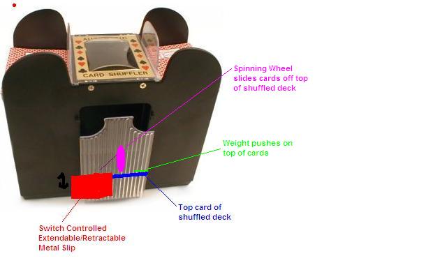

I was thinking of a spinning friction wheel as well. Here's the idea i've been toying with:
Once the cards are in the middle, I would
1.) Drop any sort of weight on top of the cards so that only one card would be dealt at a time.
-I could do this by putting some sort of extendable piece that would pop out and push down on the cards when all have been shuffled, probabbly more towards the back end of the cards.
-The reason for this is b/c I would obviously have to get rid of the plastic piece in the middle and I want to make 100% sure that only one card is dealt at a time.
2.) Use a spinning wheel (on the top of the cards) to deal out the cards face down.
-Probably have some sort of 'gummy' type material so it will create more friction on the card than a plastic material would and actually grab the card well and shoot it out.
3.) When I want to deal a card face up, then I would extend some sort of slip in front of the cards so that as the wheel spun the card out, the card would hit this slip and basically bow up and flip over.
-obviously there would be a decent amount of angle and wheel speed corrections that would have to be involved in this to make it work correctly which is why I'm thinking there may be a better way.
I attached another pic(card dealer_idea) to sort of illustrate what i mean by this. Sorry for the crude paint drawing.
What do you think about this? Or now that you've seen what the card shuffler actually looks like maybe there are other ideas that come to mind. BTW I'd rather not build a card shuffler from scratch, but would be willing to if I end up realizing the hack is going to be more work than working from scratch.

My first impression when reading your original post was (and still is) that the wheel-grip-shooting mechanism was the best way to go. I'm still not 100% about how exactly the existing shuffler works - is there any way for you to post a Youtube (or something) video? I think that'd make it easier for me to comment on your modification options.
I think your idea for flipping the cards is a good one, too, provided they're shot out of the dealer fast enough. It'll take some experimenting, particularly given variations in the playing surface (or can you control that?) and the direction the card's shooting in.
You could probably rig up something simple in an afternoon, just to play around a bit. Your test-dealer could just be manually operated while you get a feel for the mechanics of dealing a single card. Try out the spinning wheel method, see if you can aim it with consistent results, and then see if you can interfere a bit with the card to make it flip consistently, too.
Seems to me that once you've a dealer that can even just do one card, then you've got the pre-fab shuffler. Mating the two should become more apparent after you've managed to realize the dealer, so I'd focus on the mechanical properties of the dealer first.

The biggest issue of mating your dealer to the shuffler that I can see now is where you would position the two relative to each other. Presumably you want to deal from the top of the deck? If so, then your extra wheel for shooting out the cards would have to retract as to not interfere with the cards when they're shuffling.
Also, you'll want to think about some kind of loading mechanism for the card being shot out (so not more than one card is dealt at a time). You could experiment with the best amount of time to power the shooting wheel so only the desired amount of cards are dealt. At the bottom of the shuffler, you could have the deck rest on a springy surface, so that the top of the deck is always positioned to point out the rifle of the dealer.
would think that to better ensure only one card shot at a time, have one wheel feed a single card to the shooting wheel rather than having a single wheel worrying about pulling a single card and shooting it.
