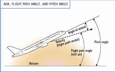

The definition of AOA is angle of the slipstream strikes the airfoil relative to the chord line of the airfoil, so yes it has to be measured relative to the air.
Measuring relative to the level is relatively easy and is part of attitude for yaw/pitch/roll measurement for the aircraft -you got accelerometers+gyro sensor fusion or mechanical equivelants like the inverted pendelum and for aircraft you also have light/UV/IR based horizon sensors.
The AOA measurement is not for attitude detection. It's to measure flight characteristics for things like optimal cruise, climb, glide, and descent. It's also used to tell how close you are to stall and how much more lift you can gain from the aircraft (when combined with airspeed measurements) Hopefully the attached diagram explains how AOA is different than the pitch of the airplane.

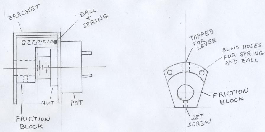

I hope you can figure out what I'm trying to show. Instead of a shaft collar I figured to make a "friction block." It will fit inside the bracket and set screw to the pot shaft. There are two small balls with small springs that will apply pressure to the inside of the bracket. Make sense?
As far as using stainless for the bracket, it's hard to form something by hand with stainless. It's springs back a lot.
Hard to make a narrow U shaped part.

THat's a pretty fancy friction disc lol. Far more than what I had in mind :) Integrated collarshaft, lever mount and friction disc mhmmm. I have very much been leaning towards a clamping method to secure the lever to the pot shaft because I didn't want to damage the pot shaft (it's stainless steel and completely rounded). I realize that the single-piece clamp collars need to flex which really limits what you can do with the collar (shape, threaded holes elsewhere in the collar). But the two-piece clamping collars seem to overcome those problems and does not place the same limits on the shape (for things like threaded holes or bulkier to accomodate its job as a friction disc).

I can make the part with a two piece clamp. The single set screw will actually hold better. As far as messing up the pot shaft, after it is adjusted the first time how often will it be changed?

quote, dknguyen " One of the things I was concerned about was metal dust being formed from a metal-on-metal friction mechanism which could dirty things up...and at worse get into the nearby PCB. DOes that happen with spring-ball friction devices? "
No the ball rolls and makes a "silk like" feel to the movement.
