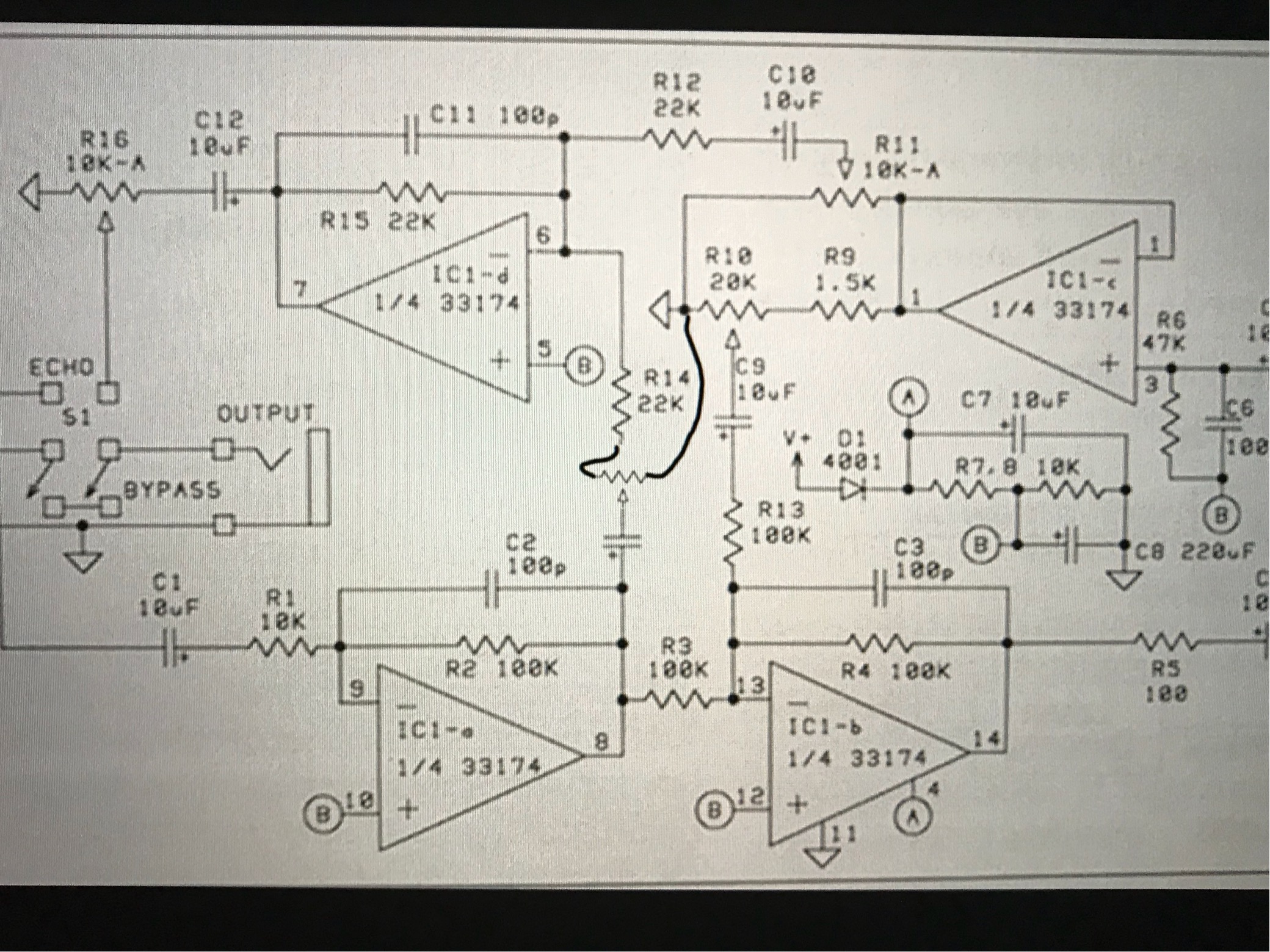

I also find this image of the circuit with a modification but no explanation of what it does?
I can se ground is moved away from the pot in the middle but dont understand the rest
I've eaten too much christmas cake so I might get this wrong.
It looks like the old circuit always introduces an amount of 'clean' unecho'd signal into the output, the mod allows you to twiddle the pot R11 from just the echo'd signal to just the clean signal.
So if you want you can have just clean or just delayed instead of having a fixed amount of clean + mixed in adjustable level delay.
Hope that makes sense.

Would it be difficult to have a new pot for dry signal allowing 100% "wet"?
Someone tried "dry signal attenuation" by adding a pot in series with R14 but that did not work.
Any ideas adding that to the circuit?

The mod in post #21 makes pot R11 adjust from 100% wet to 100% dry.
Your idea is #25 might work if you swap the pot connections going to pin 8 of the op amp and R14, the pot would need to be a low resistance like 1k, 10k would work but the linearity would be squiffy.

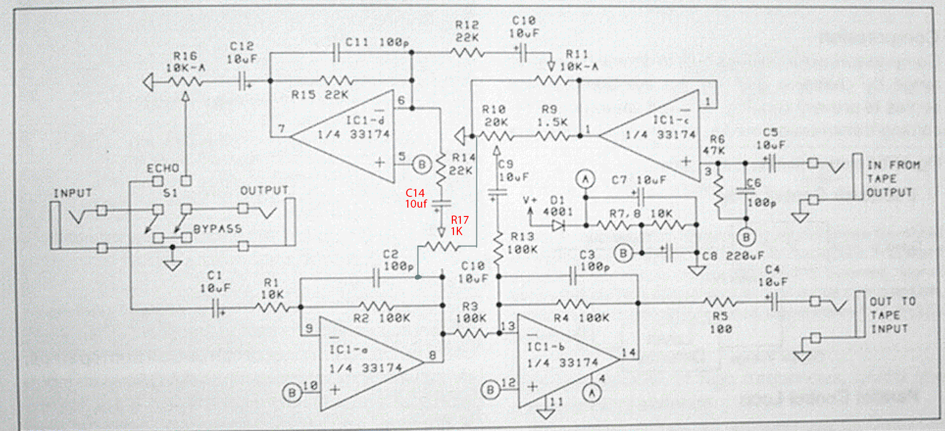

Is this looking better?
And should all pots be log pots? Or just the output level? Can I buy 1K log pots?

Why suddenly 1K?, it should be 10K like the other one. Also you have C14 the wrong way round, it need to be the same as the other capacitor.
All pots need to be log - value isn't criticial - 10K would be fine for all, as would 4.7K or 22K.
I advised the 1k as the impedance the output of the pot goes to a 22k load, 10k will work but it wouldnt be linear.
Not really a problem, and if it concerned you simply alter the 22K resistors and associated feedback resistors - but the design already uses 10K in the exact same way.

If you have 10k rorut try it it'll probably work fine I might have been a bit too picky.
