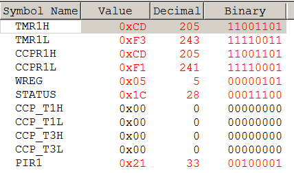

Yes, the registers should highlight. Here is an example from a working simulation:
John

The breakpoint was at the next instruction. In the "run" mode, I don't think live updates work, and even if they did, my reflexes are too slow at 8 MHz. ;) Changes since last breakpoint are highlighted.
John

BTW, TMR1 is 2 Tcy greater than CCPR1 because btfss takes 2 cycles when there is a change in PC, as there was in jumping to the breakpoint.
btfss      PIR1,CCP1IF
goto       $-1
next step (breakpoint)
TMR1 runs continuously; CCPR1 was captured before the breakpoint. I didn't mean to be flippant with that answer before.
