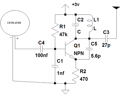

I got to fiddling around with this idea finally.
I sort of got it to work earlier when I tried a 10k for R1 and a 100 ohm for R2. I had to hold the radio very close to the transmitter and I got the sound all over the dial, but it was very fuzzy (i was overloading the front end). If the fuzziness hadn't been there and it was a bit louder, it would have sounded great.
I tried it first that way instead of the schematic, don't ask why :roll:
The schematic version will not make squat.
Is this even plausible?
P.S. I know its not gonna be stereo and i dont care 8)

You need an attenuator on the input from the CD player, it's FAR too large an input for the transmitter. I'd be inclined to add a 10K volume contol on the input of the transmitter, and feed it via a 100K resistor from the CD player.
Thanx Nigel. I hate to imagine how overloaded the thing would have been w/o that 100k because I never got it to work before I put it in.
Im having a small problem. The circuit will only work if either there is no antenna, or there is no input, one or the other. I believe that these two things are creating parasitic capacitance? How would I go about remedying this?
Hi Zach,
Your circuit doesn't have a very important 0.001uF to 0.01uF ceramic disc bypass cap across the battery connection to the circuit board with very short wires. When the 3V is fluctuating at about 100MHz, the transistor doesn't have any gain.

I would suspect it's probably making it work correctly, so the frequency may be a LOT different - try altering the coil with the capacitor fitted - it is an ESSENTIAL part of the design, in any circuit really!.
hey Zach,
Nigel is correct, maybe your transmitter needs re-tuning with the 0.001uF cap.
Is it actually a 0.001uF low-inductance ceramic disc, which is 1000pF, or 0.001mF, which is a 1uF electrolytic with a lot of built-in inductance?
Likewise for the cap at the base of the transistor.

i was actually getting something over my radio with the .001uf, but very faint, maybe it was harmonics.
yes, the .001uf is a ceramic disc.
