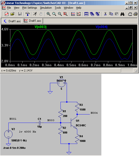

Here is a SPCIE CE amplifier which just does not give me a proper trace.
I am sure I did not manage to give proper resistor values.
I am plotting V(n001) and V(n003)
Can some one correct this for me.
Thanks in advance.
What do you want the transistor to do?
1) It is only an inverter with a voltage gain of slightly less than 1.
2) Its base resistors have extremely low values so will load-down most sources.
3) It doesn't have an input coupling capacitor so its source can upset its DC bias.
4) Its base voltage is very low so the transistor is nearly cut-off.

I am trying to make an amplifier.
V(n001) is the base node. The signal at the base is 20 microvolts. The source is set to have 0 DC offset therfore I omitted the coupling capacitor.
V(n003) is the output
All I got was two straight lines.
I am new to SPICE and wanted to try a few biasing circuits and simple transistor amplifier. I used the BC548 because I had used it in thye real world for switching purposes. I never made an amplifier. :( :(
I got the darn thingy to work:
1) I added a 10uF input coupling capacitor so the source doesn't short the DC base bias voltage to ground.
2) I changed the horizontal display timing to Left= 0s, Tick= 200us and Right= 1ms so it shows waves of the 4kHz.
3) I changed the input peak signal voltage to 1V.
It looks like Vn003 is the emitter voltage and Vn004 is the collector voltage. As I guessed, the transistor circuit has a voltage gain of slightly less than 1 and is incorrectly biased with its DC base voltage too low causing its collector voltage to be high near cutoff and showing its positive-going waveform clipped at +5V.
Goody! That's the 1st sim that I have ever run! :lol:
Thanks Audio Guru.
I managed to get an output too...
And I find it hard to believe that an electronics god runs his first simulation... Really !!!
I did not realize the capacitor at the input was this indispensable.
Thanks again...

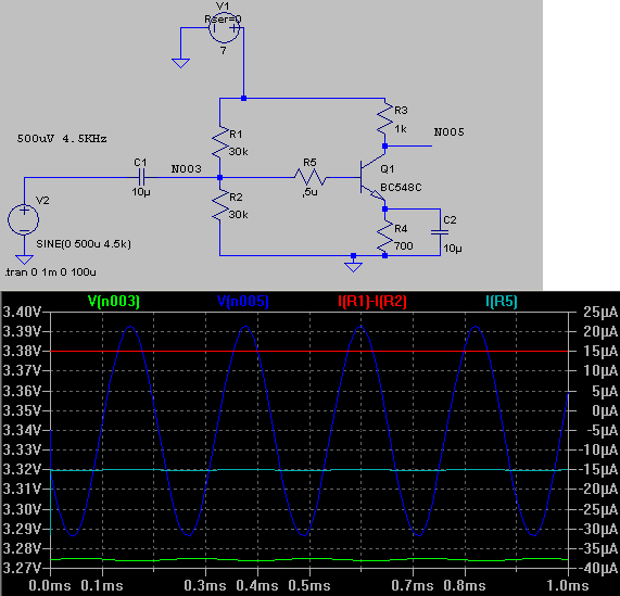

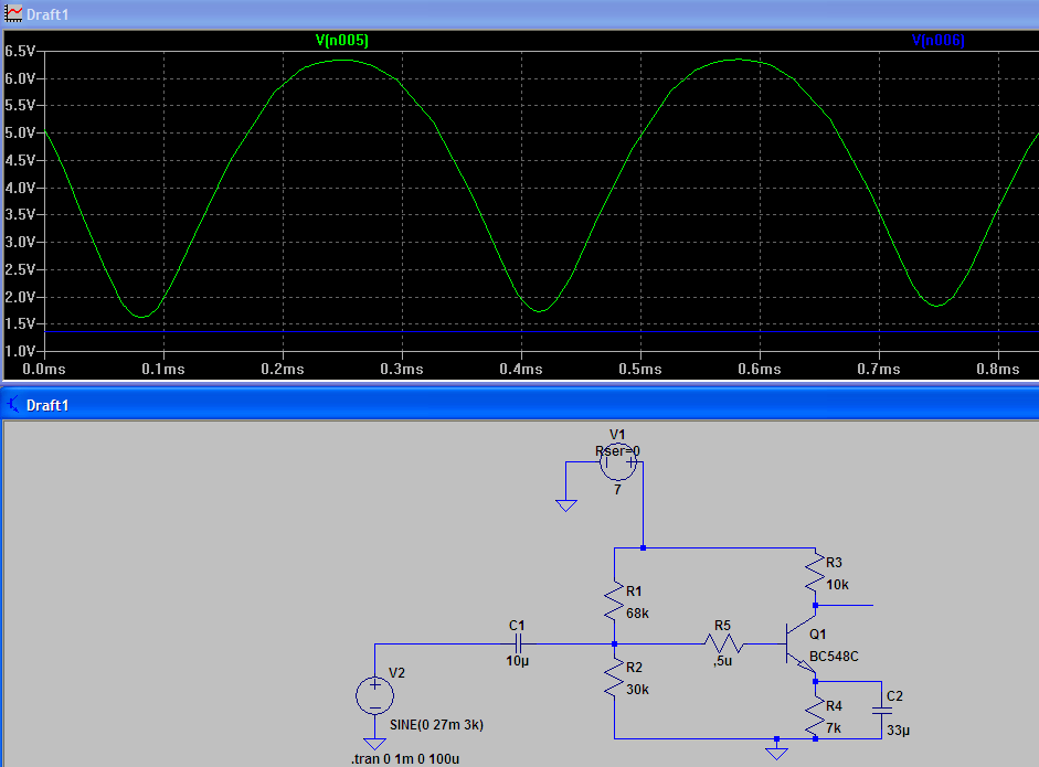

I managed to get some gain.
The traces to be seen are
V(n005) - Output
V(n003) - Input
I(R1)-I(R2) - The Base Current
I (R5) - Base current again.
But the base current does not seem to be constant. It is a wave. This means a constant shift of the operating point. I tried to Bypass the R2 with a capacitor, but the gain reduced terribley as all the signals were grounded.
Good, you bypassed the emitter resistor which removed the negative feedback from it. So you traded good linearity for gain.
Try increasing the input level and see gross distortion at the output.
I also got more gain by increasing the value of the collector resistor then changing the base voltage so the transistor doesn't clip. With a higher input level then the distortion is obvious. The top half of the waveform is severely compressed.
But the base current does not seem to be constant. It is a wave. This means a constant shift of the operating point. I tried to Bypass the R2 with a capacitor, but the gain reduced terribly as all the signals were grounded.
Of course the base current, emitter current and collector current change with the input signal, according to Ohm's Law. If the currents were constant then there wouldn't be any output, wouldn't it?

I thought one only traded the bandwidth for gain... But now I see that one has to trade linearity as well :(
But I guess it is okay if the input signal is low...
And you have placed a 33uF capacitor to bypass the emitter resistor... and further reduce the negetive feedback.
And no matter how I arranged the resistor values, I always got compression in the +ve cycle...
Is there a way around without distortion...
Thanks a lot audio guru....I learnt a lot...and am looking forward to learn more from you.... :)

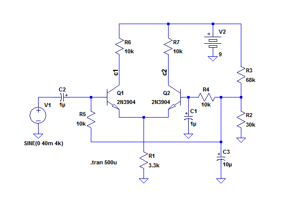

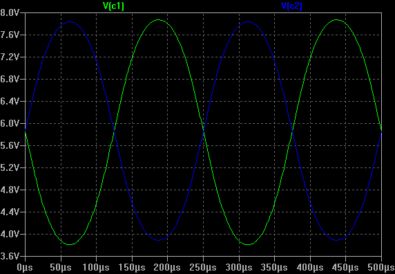

A diff amp has much lower distortion than a CE amp, due to the fact that the change in transconductance (emitter resistance) is somewhat complementary in the two transistors. Harmonic distortion at the levels shown simulates as better than -40dB (see FFT). On c2 (not plotted here), 2nd harmonic distortion is better than -60dB.

Hi Ron,
I'm surprised that the gain of the differential amp is so high at 50. It looks like the Total Harmonic Distortion is about only (!) 3% and 0.3%.

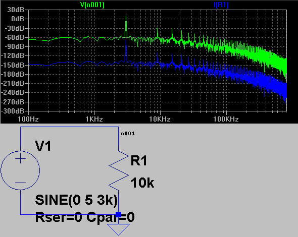

I have seen FFT graphs in swCAD could never interpret them. What are they for?
What do I see in a FFT graph? and what are the graphs plotted against?
I studied Fourier series, and figure out that a Fourier series of a function is the function expressed as a sum of it's sinusoidal components with progressively reducing amplitudes and increasing frequencies.

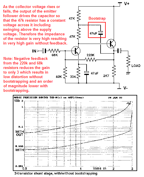

Also Audioguru, I do not figure out what bootstrapped resistor mean? (I tried google and got no explaination)...

You have an input of 40mV peak producing 2V peak output, the gain is 50.
You show the 2nd and 3rd harmonics at -40dB which is 1/100= 1% each plus the remaining harmonics add up to another 1% so the total for the harmonics is about 3% distortion.
Harmonics at -60dB each produce 0.1% distortion so their total is about 0.3% for the other side of the diff amp.
They show all harmonics of a signal. look at the sine-wave input signal which doesn't have any harmonics. Look at the cool display of harmonics in a triangle wave.
This article describes methods to reduce distortion in transistor amps.
I explain how it works in a pic attached.

audioguru said:

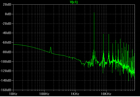

This is what I saw when I tried to get the FFT of a Sine wave... I expected a single peak. :( Or have I made a mistake...
Thank you.
