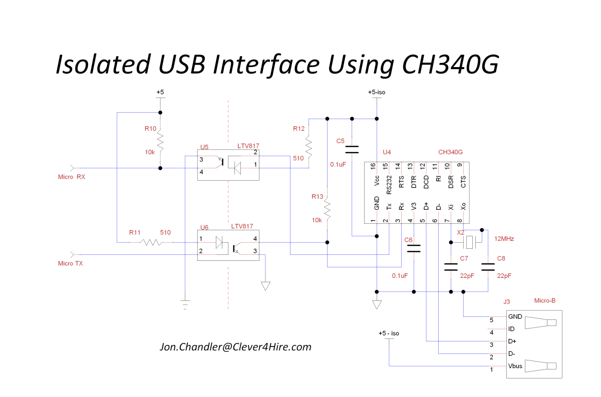

I'm having some communications issues with a CH340 UART - USB chips. They work great with a 3 - 4 foot USB cable but with longer cables they aren't working reliably or at all. The device may or may not be recognized but no data is sent if it is recognized with a longer cable.
Is this a common, known problem? I can't believe my circuit is the problem, with about an inch of parallel tracks between connector and chip.

The CH340 is powered from the host. The rest of the circuit is isolated with its own power supply.
3 or 4 feet is the longest that works reliably.
I'm mostly wondering if this is a known condition with this chip. Being able to reliably use a 6' cable would be nice.
Specifically, I'm asking about the performance of the CH340G, 6' seems like a reasonable length of cable. I'm wondering if anyone else has experienced this or if it's unusual.

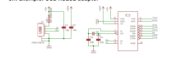

I used the circuit that's in there data sheet to make mine.
Maybe I read the wrong data sheet, but the frequency response on the opto seem kinda low for USB.
They are on the UART side of the chip, and I'm running 9600 baud, so they're not part of the problem

It is not clear what pin 3, Rx, on the CH340G comprises, but it seems that the drive to pin3 needs a bit of consideration. R13, 10K, seems high and a pull-down resistor would seem to be required.
spec
The circuit works flawlessly with a 3' USB cable, so I believe my circuit on the UART side of the chip is ok. It's based on a circuit in the "data sheet" with the exception of leaving out what they call a buffer/show as an inverter on the lines from the from the micro in case it's lacking in drive current.
