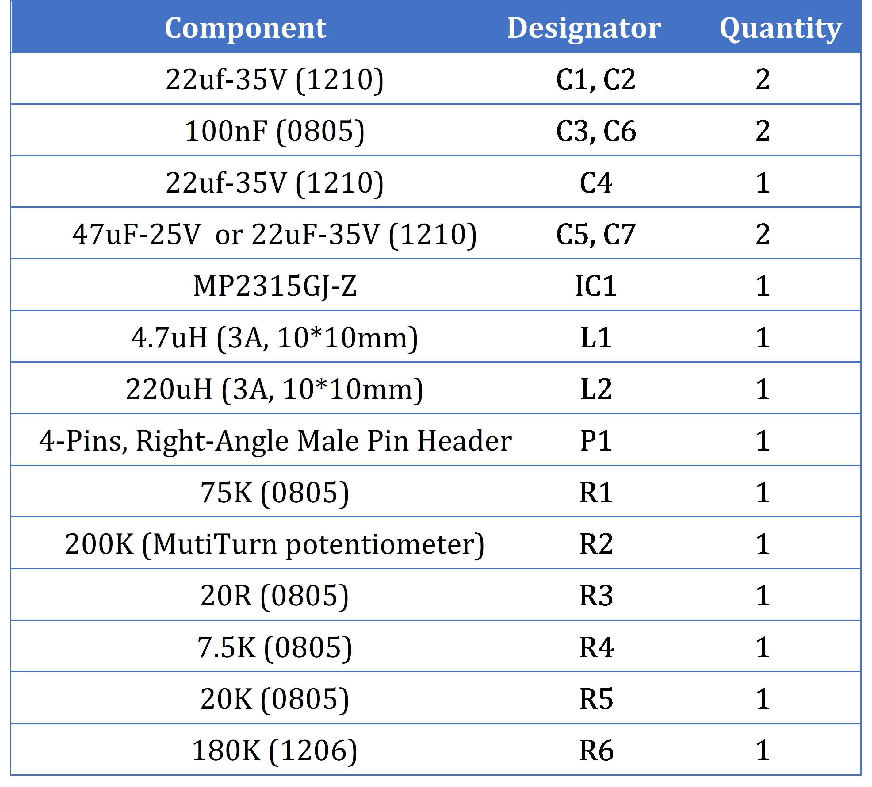

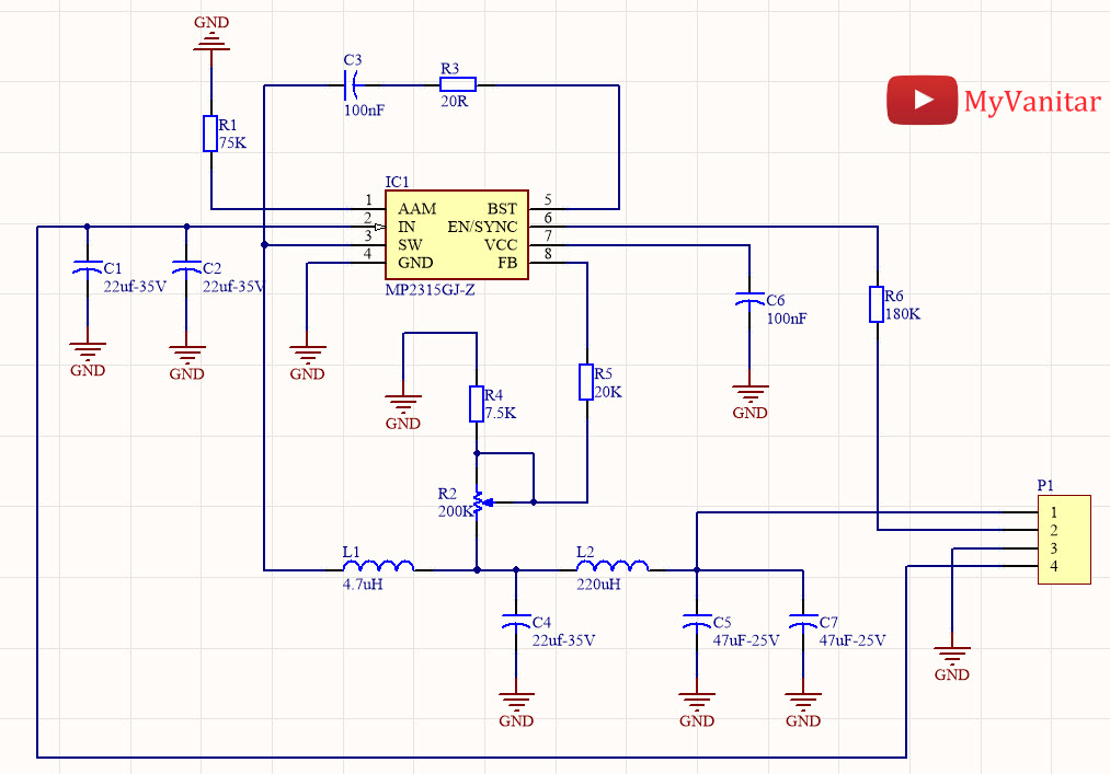

I spent some time looking at different modules to purchase and in my interest to know what is a "better" module i ran into this article. He says his module is efficient and can handle about 3 amps. His design uses MP2315. While i dont know one from the other he built this following the datasheet specs then performed numerous tests.
I have learned what makes a good buck is its efficiency and low noise. This is 97% efficient and has low noise & ripple. He accomplishes the input noise issue with capacitors and ads an additional inductor and a pair of caps for the ripple.
I am able to acquire all the parts as through hole. The 35V caps were difficult but i did eventually locate them as Electrolitic SMD.
Ill post the link and schamatic here. Please provide your feedback.
DC DC Buck Converter

A few parts will have not so obvious critical values for the design to hold spec.
Some of these are C1,C2,C4,C5,C7, (esr) and L1,L2 (serial resistance).

Thank you. Im glad the module is good. Im excited to build this. I spent a few hours and drew a schematic and PCB. While I do have 1/8 watt resistors (0805) and 100nf caps are also 0805 I am using Electrolytic Caps rated 50V for C1,2,4,5 & 7. L1 & L2 are through hole.
A question i have is would it be an improvement if i used 1/4 watt resistors?
Meaning they can be rated less that 35 / 25 volts?
could you elaborate on the Inductors (serial resistance)

ESR is Equivalent Series Resistance. This is a real resistance that is inherent in all real world components. And, like a resistor, heat will be generated when current flows through this resistance.
For a capacitor, while no DC current flows through it, in a switching power supply like this, there are pulses of current that flow in and out of it. A capacitor with a higher ESR than another, will generate more internal heat.
For an inductor, the same is true. The current through the inductors will cause heat in the parts just like it would in a resistor.
Inductors also have two current ratings. One is the saturation current. That is the level of current where it no longer behaves like an inductor, and is just a piece of wire. The second rating is temperature rise. This is the point where the inductance falls off. The temperature of an inductor will be the combination of it's ambient plus the rise over ambient due to it's operation.
The operational current through the main inductor in a buck converter is not constant, but ramps up and down. It ramps up when the switch is on, then ramps down when the switch is off. This is known as the free wheel period. See the figure in post #4 above. The output current will be the average of these two periods.
The datasheet gives more details about choosing the actual components for a good design.
PCB layout is also very important is switch mode power supplies. It's not just about connecting everything up to match the schematic. You need to understand where all of the current loops are and make them as small as possible.

Thank you for the information. Ive made changes to the PCB layout. I do think this is better suited for the components functions. Please let me know if ive got this right.
