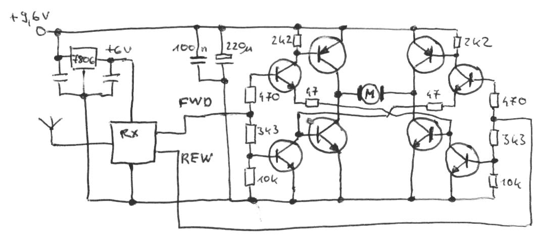

i wish to use a digital control signal (1 or 0) to control a 9.6 V DC motor.
The direction of DC motor depends on voltage polarity.
when the signal is '1' (5v), the motor will move in one direction, and when the signal is '0' (0v),
the motor will move in opposite direction. in another word, how to change the polarity of output voltage?
CASE 2:
I am using a 27 MHz Tx/Rx. When i pressed forward, the output is '+ -'; when i pressed backward, the output is '- +'.
i wish to connect directly to the dc motor. However, the output of the Rx is just about 6V. I wish to 'step-up' the output to 9.6V, how to do this?

For polarity changing use a H-bridge.
