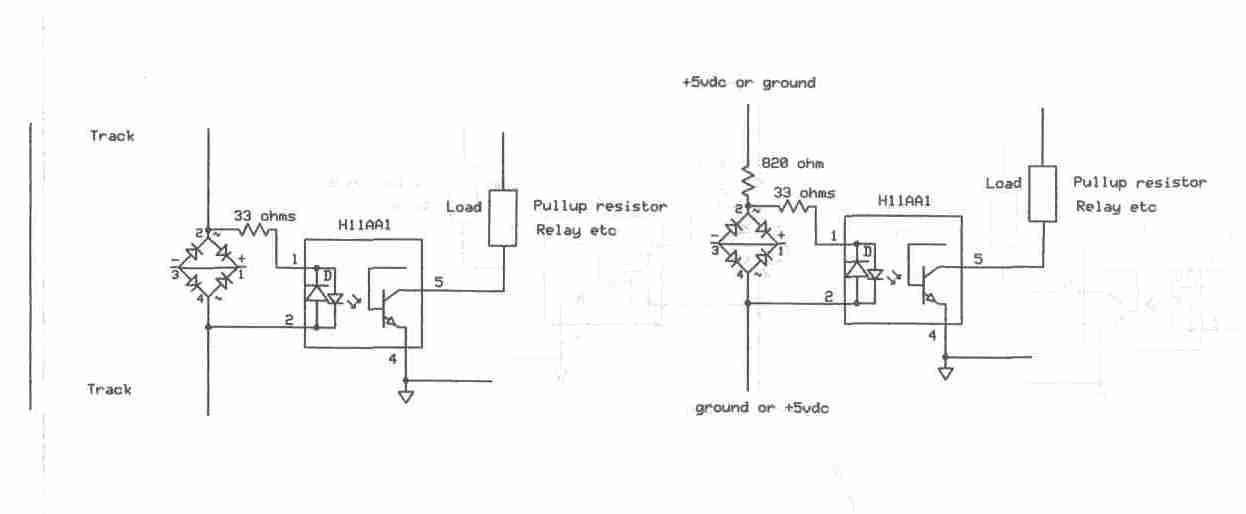

PS Forget my question above. Here are the circuits. The one on the left is used for train detection and I have over a dozen on my layout that work perfectly.
The one on the right is supposed to work the same but is very dependent on the type of DIP bridge rectifier used.
A VM18 works - a B40C800DM and a EDI-PL10 don't work. Seems there is not enough voltage drop
across the two latter bridges to fully turn on the H11AA1.

Why don't you just increase the resistance of the pullup resistor on the collector of the photo-transistor?
I agree with Mike. The transistor collector resistor is apparently too small.
According to the data sheet, the maximum "ON" transistor current is about 20% of the LED current you are applying to the coupler. So adjust the collector resistance accordingly.

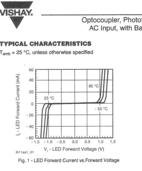

BTW the turnon voltage for the H11AA1 is 0.95 volts to 1.1 volts temperature dependent.
I measured 1.2 volts across the VM18 bridge and 0.95 volts across the B40C800DM
which supports my supposition above. Not a very stable design.

The emitters in the opto-coupler are LEDS, and as such, are CURRENT operated devices, not VOLTAGE operated. For normal operation, the CURRENT through the LED should be ~10mA. The forward voltage drop is 1.2 to 1.5V. When you put an appropriate current limiting resistor (one that drops at least 2 to 3V so the current remains more-or-less constant) and add that 2V to the 1.2V to the forward drop across the LED means that you need an minimum voltage of ~3.2V.
What is the role of the "shorted" bridge rectifier? Are you trying to develop enough voltage across the two diode drops to operate the opto-isolator emitter? If so, that is not the way to build a "current sensor".

The emitters may be current operated but if you don't apply ~1 volt they won't operate at all - see the spec sheet.

That is exactly the role of the short from + to - . And it works for me in at least 15 circuits. Suggest you see N-Scale Magazine May-June 1993 page 54.

It is a very marginal design, which is WHAT YOU ARE COMPLAING ABOUT!
I can see using the bridge rectifyer for train detection, But I dont see a use for the one on the right. Just power the opto from the 5 volts using a dropping resistor and forget the bridge rectifyer. Andy
