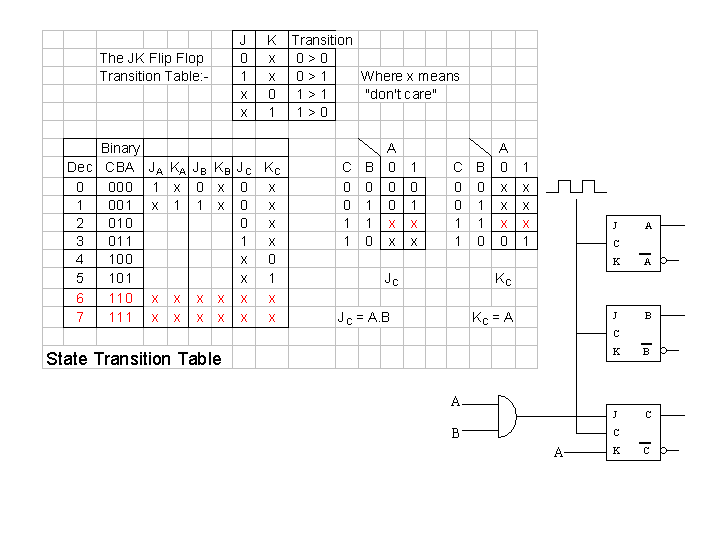

:D hi ,
i am in great doubt regarding the characterstics table of J-K flip flop,will any one plz tell me how we create the characterstics table with the help of truth table and without it by knowing only the circuit diagram. :?:
I'm assuming you mean the excitation table? I've got a class in 2 minutes, but afterwards I'll draw it out for you.
See my response dated April 11 2004 to a post by Satellite 5005.
This will give you an example of how to design a counter using JKs.

Do a search of my posts and look for "I need help Digital Clock" posted on April 11.
Len

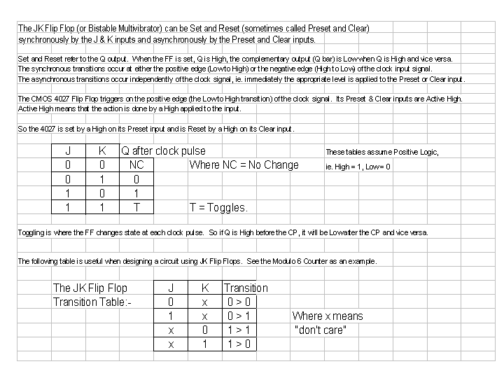

Here is a description of the JK Flip Flop and a partly worked example (anyone that needs the practice can complete it) of a Modulo 6 counter using JKs.
hello,
j k q
0 0 no change
0 1 reset(0)
1 0 SET(1)
1 1 toggle(not q)
from the circuit just give the inputs and scan thru the gates as in normal combonational circuits and obtain o/p . if this again changing the i/p then again scan thru it
