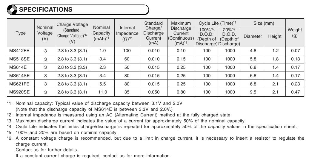

Do you have a sped sheet for the battery? I never heard of a 3.1V Li battery.
EDIT TO ADD: The ads for the battery do call it a "3.1V rechargeable Li battery". Data sheet:
https://www.electro-tech-online.com/custompdfs/2009/08/321180.pdf.
It looks fairly simple, just connect to a 3.3V regulated supply via a suitable series resistor, see data sheet.
What are you going to power using these tiny cells? They're designed for very low current applications.
Looking at that data sheet then I am interested in what it shows.
Here is the specs bit
So what are they saying , on the first line that battery has a normal voltage of 3Volts.
An ability to supply (capacity of) 1milliAmp per second for 1 hour .
Discharge it at 10 micro Amps per second generally and maximum 100 microAmps ?
Charge it at 10 microAmps/sec with a constant voltage of 3.1Volts and regulate the charge current with a resistor to drop it to 10microAmps/sec.
If discharged to 80% of its nominal voltage (which is 3.1V so at 2.8Vrecharge it ) then recharged it will last for 1000 cycles.
If discharged to 0V then recharged you will only get 100 cycles out of it.
Am I reading this right?
