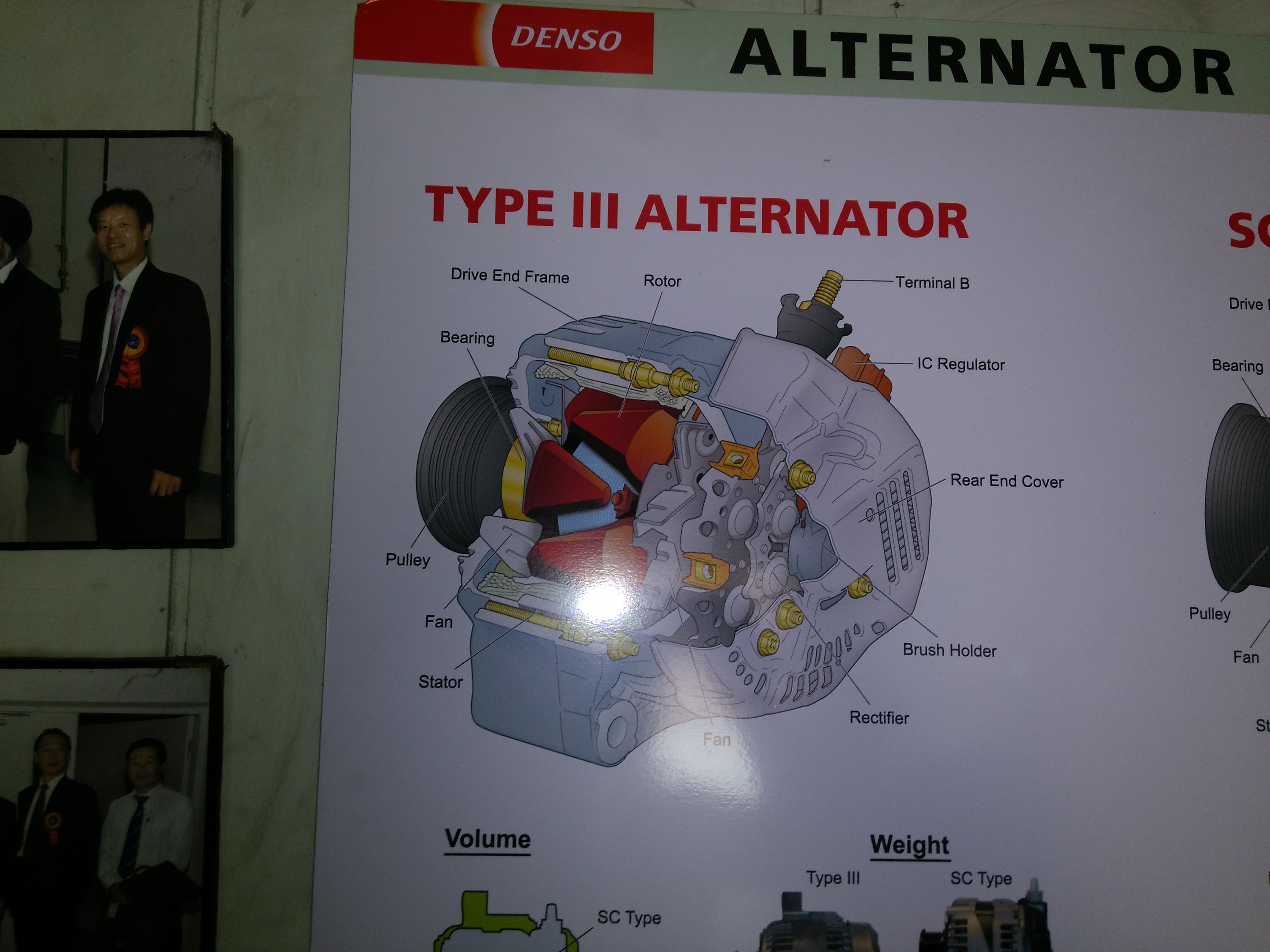

I was looking at the alternator component and i find this chart showing different parts.. Iam using the same alternator as described in the diagram attached..
Few questions...
Is it the same bridge rectifier as u were talking about..
And there is a ic regulator.. Is'nt this is supposed to give a constant voltage..
And the electrician was saying that this regultor IC could detect automatically what type of battery is attached to it.. And charge according to it.. But i have dought on what he is saying..

The alternator is made for a car or motorcycle to charge an old fashioned very large lead-acid battery. Simply look in Google for Denso Alternator to see. DO NOT connect a Li-Ion battery to it.
If the alternator is pseudo-regulated, limiting its upper voltage to a known value, you may be able to use this as a power supply for your charger. Please note, as audioguru said above you cannot connect this 'directly' to a Lithium battery.
There are *many* IC's for battery charging, that can vary from simple 8-pin linear regulators for single cells, to 64 pin entire battery management systems that can work with a wide input voltage range. I would advise you use a chip specifically designed for charging lithium batteries of the number of cells you have (7 if I read the above correctly). Almost all of these are surface mount components, would require a custom PCB, but they can also handle the cell balancing, and perhaps form a switching power supply so you can use a lower voltage as your input.
as I said before a 7-cell charger, even with a simple 35V power supply, is a complicated project. Not just to ensure long battery life and good charge times, but also so it doesn't permanently ruin the battery cells. If you can find an 'off the shelve' charger that can be powered by DC, say 48V, then I would use that, along with a boost power supply to step up your alternators voltage from ~15V to 48V. It will be very inefficient, but would probably be the fastest way to actually 'build' the project.
