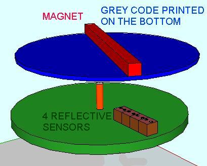

please see the image below in reference to a cheap compass. I'm not an electronic engineer so pls bear in mind :)
the idea is to create cheapest form of electronic compass. it will be in-accurate by about 15degrees, slower than gyro ones, and need to be held flat like a compass. Whats wanted is cheap + general direction according to 8 co-ordinates.
just like with normal compass, its bar rotates on a pin. the bar is fixed to a black card (thin, light, black about 200gr/gsm card). A slot in the card to allow IR light to pass through for the photo interuptors. depending on the cards rotated position, 1 or 2 photo interupters would be postive (passing IR light through the slot. With each photo interupter connected to an MCU pin each, could calculate the position......

How are you going to keep your robot level and still while you take compass readings with your original design?
as long as its level within 12 degrees, should be fine. it doesn't move that much :) im changing the above design, replacing single hole on card with slots which will be counted - just need figure out a way to calcualte direction using photodiodes
Another problem is the compass needle will only block the light when it's directly over the optical sensor. 99% of the directions will show nothing. Add the time & cost of a DIY design to the price of a modern 2 or 3 axis chip ~$30 and the chip will be cheaper.
i see your point. the card will have holes round its edge. those holes depending on the position of the needle will allow/block the optical sensors.
If you used Grey code wheel printed on the bottom of your card and reflective sensors, you would get 16 positions with just four sensors and each additional sensor would double number of them. Also it would be easier and cheaper to make than cutting holes or slot.

hi jirka, great reply thanks....would you mind doing me a drawing of some sort so i could understand you better? (think your idea is great) :)
Hi, the picture shows what I meant. The encoding disc would be printed on paper and glued to the bottom of blue disk. Four sensors would read it. You would have to decode grey code to binary in your MCU.

Hi Jirka,
Yes i see your idea. It's good. You mount all the sensors on the same tangent line.
