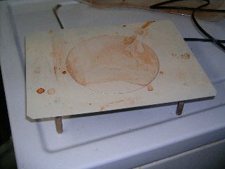

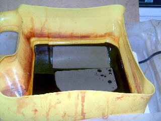

A Coffee Pot Warmer Works Great.
I bought one in a second hand store for $2.00. I than Modified it by adding a fairly large Aluminum Plate to the top of it.
I than took a 1 Gallon Plastic container and cut it in Half, Sideways, so as to give me a fairly large heating tray.
Placed on top of the Coffee pot heater, it keeps the Ferric chloride at a really nice Temperature.
See Pictures.
