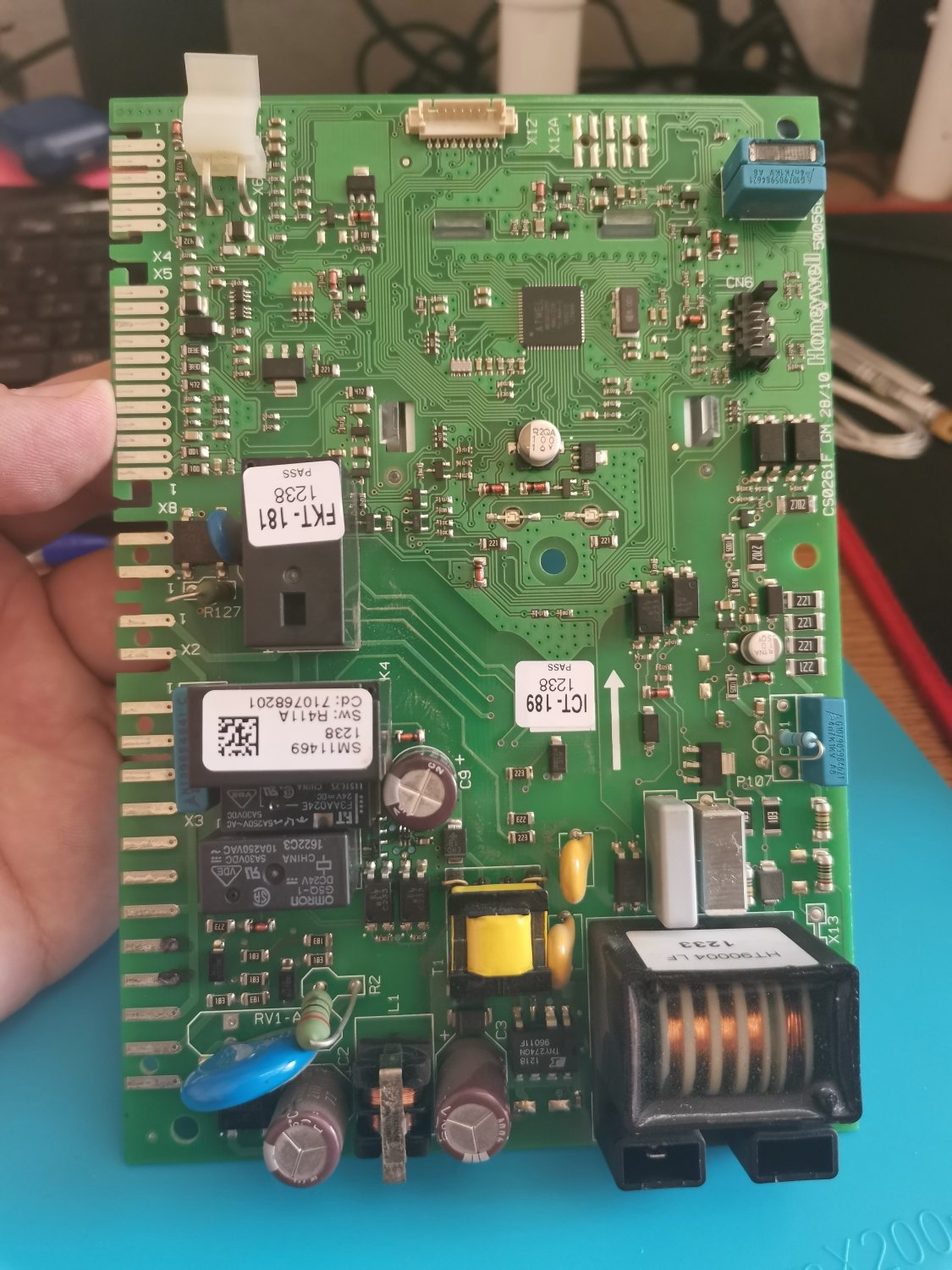

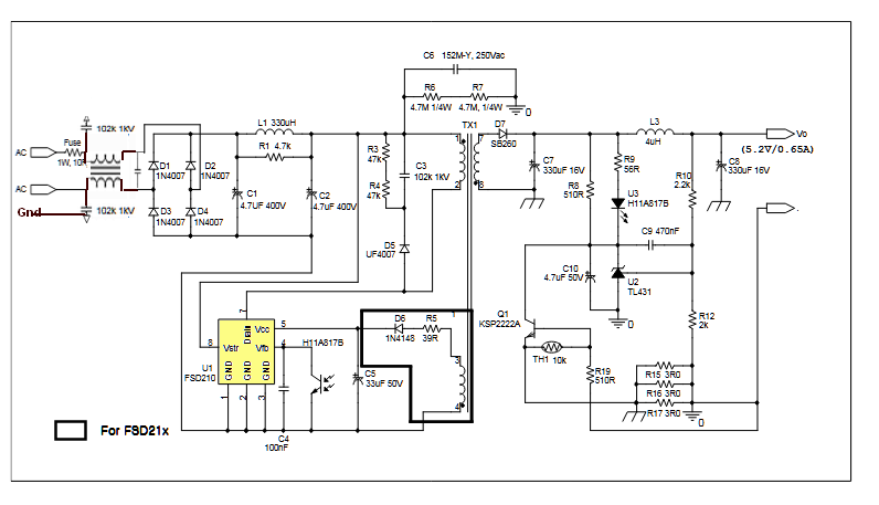

Update#2--: My Mains Heater Board's Fly-Back Regulator Has a Busted Switch (feedback power switch), but Why?
Popcorn failures are either from shoot-thru issues in general, may be caused by;
- complementary drivers with no dead time (thermal runaway)
- dielectric breakdown failures (arc trigger)
- reverse conduction failures
- CMOS I/O's exceeding Vdd,Vss
This failure occurred because the root cause was not adequately identified and then corrected.
None of the above failure modes can be corrected by slow front-end fusing.
I never found out if power is cycled on the input with something or not and what event if any coincided with the failure like "demand heat" on thermostat.

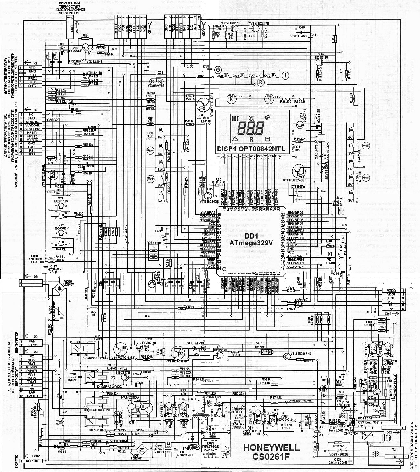

You can update the schematic if you like for your own learning curve.

SMCOKA01, Demrad, SM18502
Answer / Solution
The PCB had a part number of SM18502.
It is an obsoleted board.
It was designed and sold to TDDF (Demir Dokum) a Turkish OEM now part of Vaillant Group.
Vaillant Group are still a viable company so they may be able to help. For more information follow this link.
or search online for spares, or call a furnaceman !
Good luck. Maybe you can replace it with a newer controller. Is it a boiler type or hot air?
