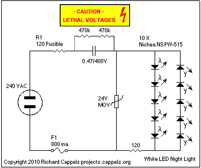

Hi Dick
All the basics are known to people that "physically" have dealt with this kind of circuitry.
Like you have.
All understandable and easy to come to grips with...
Until one specific member here always starts making simple things complicated and it frustrates the hell out of me :banghead:.
Regards,
tvtech
Questions:
Why two 120 ohm resistors? The one in the bottom right corner is in series with R1. Why not 240 ohm fusible R1 and remove the other.
Why two fuses? Oh yes 220 and you need a fuse in each power leg. Then why not two 120 ohm fusible resistors and remove F1?
Any way, there is often that 120 ohm resistor, that I don't think is needed. C0.47uf/400V is limiting 50/60hz current. R1 limits high frequency current.

I designed and did production on a product like that. Passed UL,CSA, VDE etc.
If I wanted some for my house and did not care about government approval:
Use the above schematic, remove R120 (short out), For the fuse and 120 ohm fuse-able resistor use 120 ohm film resistors. They will blow open in the case of a short. Remove the MOV.
For my house I would bring the LEDs out to the front panel. For UL we had to add a plexiglass window. (double insulated)

Hi Ron. Interesting stuff about the product passing UL, CSA, VDE etc.
I have always had a gut feeling on my little design an LED poking out through the face would fail it in Safety testing. I thought about that a while ago and now you have confirmed it.
Relatively easy for me to fix though. Without any PCB changes or such. With a little bit of luck, this design of mine is going to fly through testing by the relevant Authorities.
If things go the way they should I would be happy to submit to VDE, CSA, UL or any others out there.
Electrically, within reason, I know they will not break it. I tried and failed.
For me now is to learn as much from the people that have actually gone there as far as casings go.
