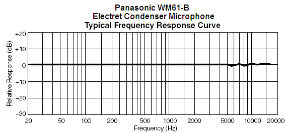

Cheap electret mics have a very flat frequency response.
Here is one:
As a matter of fact that is the one I was looking at. I only wish it had better noise figures, but I guess 62 dB is pretty good for a microphone.

I think it's just the nature of dynamic mics.
At the time I was looking through a catalogue for small dynamic mics as used in cheap applicances, cellphones, headsets etc and there hundreds of mics all with little charts, and none of the charts looked good. ;)
A dynamic mic is like a little speaker. It has a magnet that has a moving coil around it to generate a signal. The coil is fairly heavy so it needs a fairly strong and heavy diaphragm to move it with sounds so its resonance is at a few thousand Hz which causes a peak in the response.
But an electret mic has a very thin and lightweight conductive film as its diaphragm so its upper frequency response is extended and is flat.
