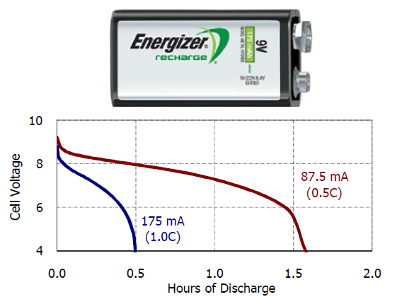

The datasheet for an Energizer brand new 9V alkaline battery with a 300mA load shows its voltage dropping to only 6V in one hour.
A transistor used as a 1.5A switch needs a base current of 150mA for it to saturate with a fairly low voltage loss. You should use a Mosfet that uses NO gate current and has an extremely small voltage loss.

Or go with a 9v nimh battery, they can give you more clout.

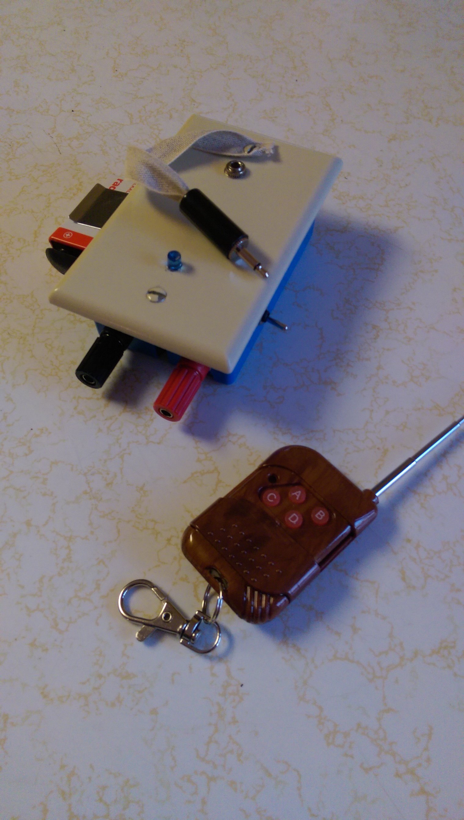

I need the pulse to last a full second maybe 1.5 sec. max. When the coil energizes allowing the 18v to pass it heats up a small piece of nichrome wire for a model rocket launcher, so I need the full amperage that I had from the batteries before I connected the 5 volt device.

Project complete. I decided to power the 5v receiver on it's own 9v battery and a regulator. I just added it to the outside of the project box. So now the 2 9v batteries in series on the inside of the box provide 18v and 2 amps of power directly through the relay, plenty of juice to light one of these homemade nitrocellulose igniters.
I betcha the 18V from the two puny batteries in series drops down to maybe 5V when loaded with the 7 ohms load. Then the current is less than 1A and the batteries will not last long.
