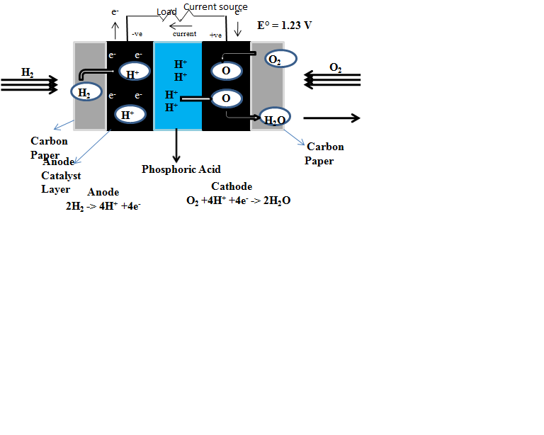

Sir, i want to design a circuit that can break Power supply (Constant current source) when cell voltage drops below 450 mV

Sir I have a setup to test a small size fuel cell.In this hydrogen and oxygen are used as fuel.In the absence of fuel ,cell potential starts decreasing and if load (Current source) is connected to the cell then cell can damage.The OCV for this cell is 1 V (approx).But if by any means there is a starvation of fuel then cell voltage starts decreasing rapidly and if load (current sourse )is connected to the cell then cell can damage.It is seen that if cell voltage is above 450 mV then cell is safe but as soon as it goes below 450 mV then cell damage .To protect the cell in the absence of fuel this protection circuit is required by disconnecting the current source(Load) from cell.schematic is attached ..

Is the load a resistor as shown in your drawing, or is it a true constant current source (sink) circuit?

So, to help determine the type of cut-out needed, what is the value of this constant current? Microamps? Many Amps? ....?
Given those voltage and current figures I think the most practical cut-out would be an automotive relay. That would need a 12V supply and a comparator circuit set to trigger at about 450mV, probably with a bit of hysteresis.

amps range 0 to 20 amps
It looks like the only source of power is the 1 to 0.45 volts from the cell. This makes most approaches not work. I think the voltage will collapse to zero for a short time. While the breaker is opening the voltage is between 0 and 0.45.
If that's the case then the only suggestion I have would be to modify a solenoid valve of the type used in flame-failure sensors. That type has a very low resistance coil powered by a thermocouple, so that even a fraction of a Volt can drive an Amp or so through the coil to hold the valve open.

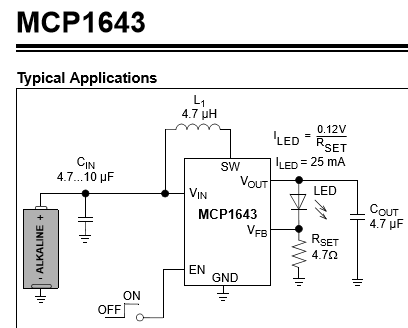

I see 1V>5V boost converters are available off-the-shelf. Might strike lucky and find they work at a tad under 1V.
I think it needs to work down to 0.45.

Here is a LED boost that can be modified for constant voltage not constant current. It works down to 0.50V.
I have used other parts that work lower but many are not in production now.

The MCP1643 needs 0.65V to 0.8V to start. A unloaded cell will do that. Once started it will work down to 0.5. I think most worked to 0.45 if the load is light.

Found boost PWM down to 0.1V but the price is 10X. "energy harvester"
