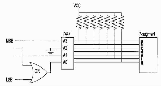

circuit design(block diagram, schematic. logic diagram) using seven segment display that uses BCD counter that displays 3 different number, example when the count is 0001 in the counter the display in the 7 segment is{ 1}, when the count is 0010 the diplay is {4}, and when the count is 0011 the diplay is {3} and when the count is 0100 the display now is ack to {1}.

This circuit will do what you said, but what happens when the count is 0101? Or don't you care?

circuit design(block diagram, schematic. logic diagram) using seven segment display that uses BCD counter that displays 3 different number, example when the count is 0001 in the counter the display in the 7 segment is{ 1}, when the count is 0010 the diplay is {4}, and when the count is 0011 the diplay is {3} and when the count is 0100 the display now is back to {1}. then 0101 {4} up to 1001 displays a {3} value
