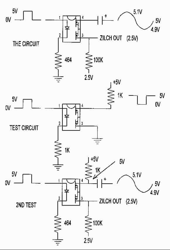

I hope someone will have an idea why this circuit is not working, I am tearing my hair out. I built it on a pc board and it worked, but I wanted to make changes, so I built a new pc board but did not change this circuit. The first circuit below is what is on the pc board. I took the solid state relay off the pc board and put it on a test board (2nd circuit) and it worked OK. I put the relay back on the pc board with the 1K resistor to simulate the test circuit, but it still does not work.

Thanks for the reply. The signal input to pin 4 should appear at pin 3 when the switch is closed; it doesn't. The test circuit shows that the switch is working, the second test indicates that it is not working on the pc board. I have not found an open or short anywhere.

The opto is Omron G3VM-S2. It has worked before, so there is something strange about this PC board that I don't understand. The input signal is from a LMC660 op amp, the load is 160K input resistor to a low pass filter.
You may be interested to know that I built a piggy-back board with only the switch on it, tied it into the pc board, and it works. So I still don't know what is wrong with the PC board, continuity checks are ok and all the signals except the output are as expected. Since it is working with the piggy-back board, I will run it that way, glueing it in place.

The opto IC is designed to switch hundreds of volts, not low level signals.
It has two identical Mosfets in series back-to-back. Each Mosfet has a diode in parallel to pass a reversed voltage.
When the signal is positive at pin 4 then the pin 4 Mosfet conducts and the diode at pin 3 conducts.
When the signal is negative at pin 4 then the diode at pin 4 conducts and the Mosfet at pin 3 conducts.
It conducts only if the voltage from pin 3 to pin 4 is about 0.7V or more.
But your signal amplitude is only 0.1V peak so the diodes do not conduct.
Of course it works when your signal is 5V.
