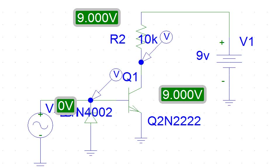

this is the out put of the simulation

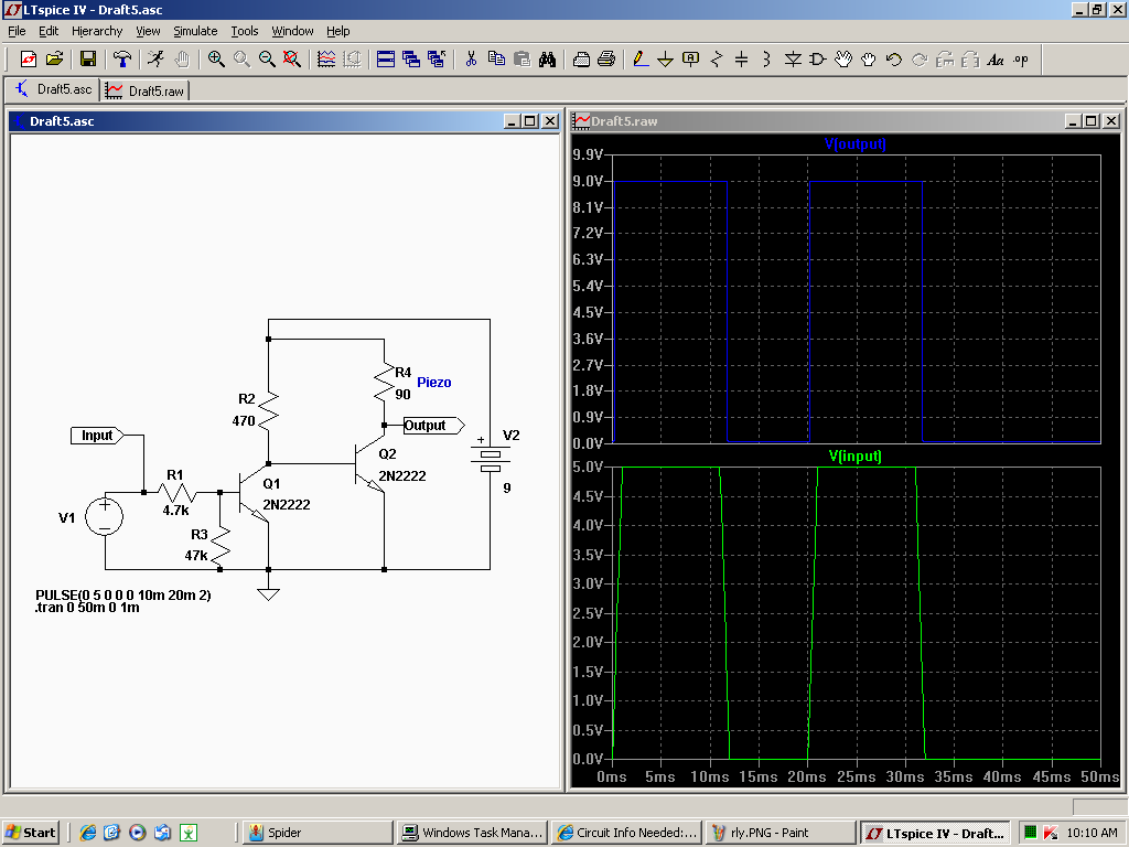

these may help you....
Driver
If I understand you right you want the buzzer to go off when the input goes low.
Here is a transistor implementation.
Thank you very much, those do help me because I'm in Afghanistan and it takes a long time for mail to reach me, but I do have transistors and resistors and can build this quickly.

ronv; You need to level shift and invert. The output of your circuit does not apper to invert. Andy
