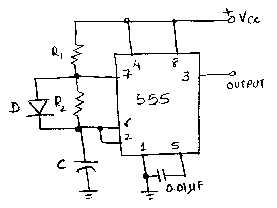

Ok here is how you generate 50% or less duty cycle from 555. Here R1= R2.

What would the values be to have it 1 second on and say 8 seconds off? Also, Is the diode necessary?
The diode is necessary only if you want on time = off time i.e. 50% duty cycle or less (<50%). Otherwise it works without it also.
For caluclations of above circuit:
T_on = 0.693 * R1 * C
T_off = 0.693 * R2 * C
and for circuit wihtout diode:
T_on = 0.693 * (R1+R2) * C
For your requirement, duty cycle is less than 50% (on time is less than off time). Therefore you have to use the above circuit with diode. The other will not work.
Assume any value of capacitor say 100uF for your case and then calculate values of R1 and R2.
1 second = 0.693 * R1 * 100E-6
Therefore, R1 = 14.43 k
Now,
8 seconds = 0.693 * R2 * 100E-6
Therefore R2 = 115.44 k
Enjoy! :)
