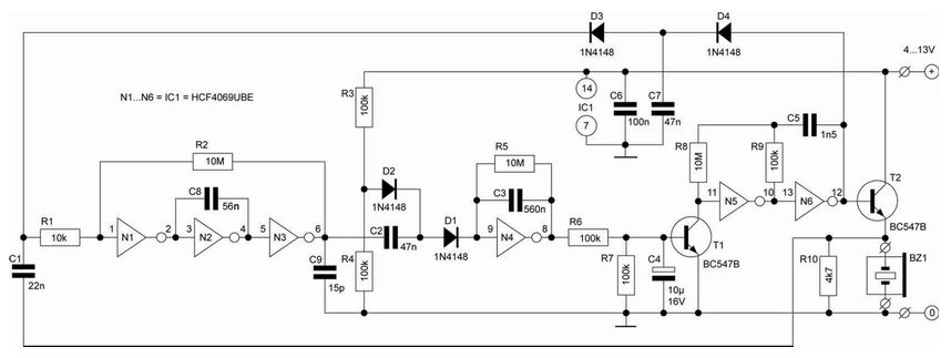

Here is a schematic of the Keys finder project that doesn't work.
It uses a peizo transducer as its microphone and beeper.
It uses a Cmos logic inverters IC as a linear amplifier that is powered most of the time so it quickly kills a tiny battery. The piezo transducer resonates at about 4kHz which is much higher than people can whistle. It is very sensitive at its resonant frequency. The highest frequency that I can whistle is 2500Hz but the transducer has poor sensitivity at this "low" frequency.
When it picks up a sound it rectifies it which turns off the preamp and turns on a beeper oscillator to make a beep.
My daughter bought a Keys Finder at The Dollar Store and asked me to fix it because it beeped whenever she talked and when the TV was turned on. Inside it had a black blob custom IC so there was nothing I could do to fix it. I think it had very low current because its battery was tiny.
