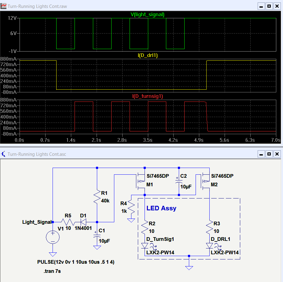

circuit to split combined DRL/turn signal into separate circuits
AMB_IV
Hello!
I'm driving a 2006 Cadillac SRX that I recently purchased. it's growing on me, but one thing that bugs me is Cadillac made the front amber turn signals do double duty as daytime running lamps (DRL). by double duty, there's only one circuit into the bulb and the flasher drives that circuit as either +12 V for DRL's, or alternating +12/0 V for turn signals (like normal). My goals:
1. I like amber turn signals but I'd really like white DRL's (like all the newer cars and the bright LED's)
2. North Carolina actually allows white turn signals but what fun is the trival solution?
I've purchased replacement LED bulbs called switchbacks that have amber LED's on one circuit and white LED's on a 2nd circuit. but they don't work because the car doesnt' have two separate circuits. So to make those work I need to split the signal like this:
schematically, it looks like this:
One point to bear in mind...the GM bulb socket wasn't fully populated ( 2 pins, 1 blank) but the aftermarket replacement parts are fully populated with three pins. so adding one more wire isn't impossible.
thanks for your time, I'm looking forward to your creative solutions!!

It isn't possible to get a circuit to do exactly what you want, but something that comes close could be done.
In your diagram, where the input turns on after the 5th off period, there is no that the circuit can know that the turn signal has been cancelled. There is no difference in the input until the normal on period has elapsed and the input stays high. Similarly if the driver cancels the turn signal during the on period, there is no change that can be detected.
You could build a circuit that would energise the turn signal if the input had been low less than one on period ago. Otherwise it would power the DRL. Also, the lights would both be powered from the input so that the turn signals would flash and so that the DRLs would turn off when the car is turned off.
If that were instituted, the turn signals would flash once when the engine starts, then the DRLs would come on. When driver indicates a turn, the DRL would turn off, and the turn signal would flash. When the driver stopped indicating a turn, the turn signal would stay on for a moment longer than the on period of the flasher, then it would turn off to be replaced by the DRL.
If you made a delay circuit powering an automotive relay, that would work. Your delay needs to be just over the on period of the turn signal, and the relay would be change-over relay, so that NC (normally closed) powers the turn signal and NO (normally open) powers the DRL. The two sides would be independent, and the whole lot would be powered from the existing input.
When the input is on, after the short delay, the relay would be energised. That would turn off the turn signal and turn on the DRL, and the relay would stay energised.
When the driver indicates a turn, the input would turn off, so both lights would be off. The relay would be de-energised. During a flash of the turn signal, the relay would stay de-energised, and the time delay would not be reached before the flash finished. As long as the turn was being indicated, there would never be long enough for the relay to be energised, so during the on periods the turn signal would be on.
When the driver stops indicating, the input would stay on continually for long enough for the delay circuit to energise the relay, and the turn signal would be turned off and the DRL turned on.

Below is the LTspice simulation of a somewhat simplified version of spec's circuit.
The time-constant R1C1 determines the delay until the running lights return after the turn signal stops. The delay needs to be slightly longer than the ON time of the turn signal.
C2 prevents short transient current glitches that appeared in the DRL LED when the turn signal was blinking.
  • Turn-Running Lights Cont.asc
The time-constant R1C1 determines the delay until the running lights return after the turn signal stops. The delay needs to be slight longer than the ON time of the turn signal.
Clever implementation.:cool:
spec
spec
Thanks.
My goal when designing circuits is the quote attributed to Einstein: "Make things as simple as possible, but not simpler."
or KISS in the popular vernacular.
In this case I think your circuit approach fits that goal better than the 555 circuit.
But the 555 circuit is more accurate. :p
spec
spec
You're throwing my own words back at me. :rolleyes:
But I guess, in this application, it seems the added accuracy is not worth the added complexity (especially compared to the simplified circuit).
I mean, how much timing accuracy does the circuit really need? ;)

I fully understand that.
I just didn't see where that would occur in the circuit I posted. :confused:
I concur. I cannot see that the Trig (or any other) input to the 555 swings above Vcc, or below Gnd.
