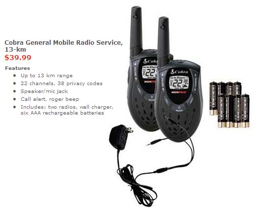

Three years ago I could buy two 2-way radios for only $40.00 and their range is 13km.
Today they are probably cheaper and have more range.

13km range with that little aerial??? Kinda hard to believe
The length of the aerial is determined by the radio frequency. Walkie Talkies for kids use 27MHz so their antennas are long.
FM radios use 100MHz so their antennas are about 80cm long. FRS and GMRS radios use 462MHz so their antennas are short.
My radio controlled airplanes use 2.4GHz (microwaves) so their antennas are only about 1.5" long.
