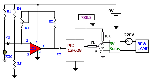

I have to buy new material for continuing experimenting, so I decided I'll try the circuit you've proposed, but I've got some questions for you about it.
I've never worked with a 555 so I do not understand it's use very well. Tell me if this theory about how does this circuit work is correct, please:
There are three parts corresponding to each IC. First getting the signal and amplifying it. This is a job for the op amp. After, with some caps and resistors a square wave is generated with the 555 which may change the output level with each clap. Finally the D flip flop mantains the level until the next clap. The following in the circuit is for exciting the relay.
If all this is true, then I could modify that circuit like this:
I want to use a PIC microcontroller because the status of the relay will be determined by more devices which I wanted to manage through the microcontroller.
Please, tell me if I'm right or not.

well the relay doesnt look well connected.........you uconnected it betwee the E and C of the thransistor. connect the relay between the C and the +5V
:?: :? I don't understand that conection you say, Bogdan; or, in another words, I don't understand why my arrangement is wrong. I connected the trt between the colector and ground. This way, when there's a high level on the PIC output the relay doesn't work. If there's a low level, the relay will work then. What I don't know is if my relay will be closed or opened when it has no 5V voltage between pins. Could you tell me where's my fault?
Apart form this. I know there's an inductor (coil?) inside the relay. It rings a bell about protecting it with a diode for high current peaks. Can anyone explain that feature to me and how should I put the diode? Thank you all.

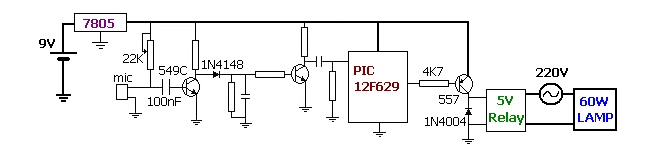

i thought that you were going to have the raelay working when you have a H from the PIC. but the way you have it, when the output of the PIC is L then there is no current trough the transistor and the relay will get power trough the 10K resistor? is this how you think? well the 10K resistor is too large so the relay will not work. i suggest using a PNP transistor. here is how....
and about the diode. you need to connect it so that it will conduct in reverse to the way the current is flowing trough the circuit

Now we wre getting somewhere!!! This looks like a much better approach and, oh yes, reconfigure the relay as bogdanfirst recommended. What is your amp output now?

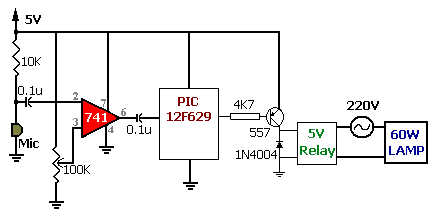

I've built the circuit shown in the previous page based on a 741 op amp (at almost the top of the page) with the change on the relay and it didn't work!!! :( :evil: I have to recognize I got in that arrangement better results than in any other before. I could measure up to 560mV (in a certain position of the pot) at the output of the amp stage (much more than the previous record of 200mV). But 0.560V wasn't a logical high level, anyway= It did not work. :cry: I was frustrated so I started messing that circuit up, changing things, and testing different combinations until... The Idea arrived :idea: :!: :eek:
I simply used the 741 in another way like is shown below, like a simple comparator.
Can you believe it? It worked at the moment :!:
This arrangement takes the signal from the microphone and compares it with a very small signal (selectable through the pot). The pot is positioned in order to equal the ambience noise, so this noise won't turn on the lamp. When the mic signal gets over the reference (a clap) the amp enters saturation, giving 5V at its output.
Awesome. It was hidden all the time. In front of my eyes while, blinded, I was trying once and again to amplificate 20mV to 5V. What do you think?
