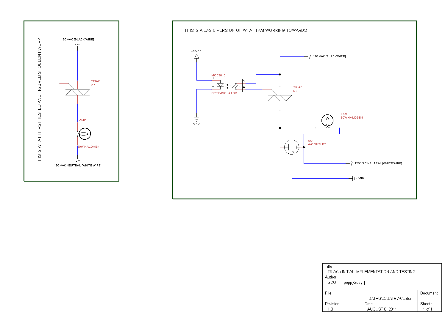

Original schematic (first attempt)
Can you post a schematic of what you are doing?

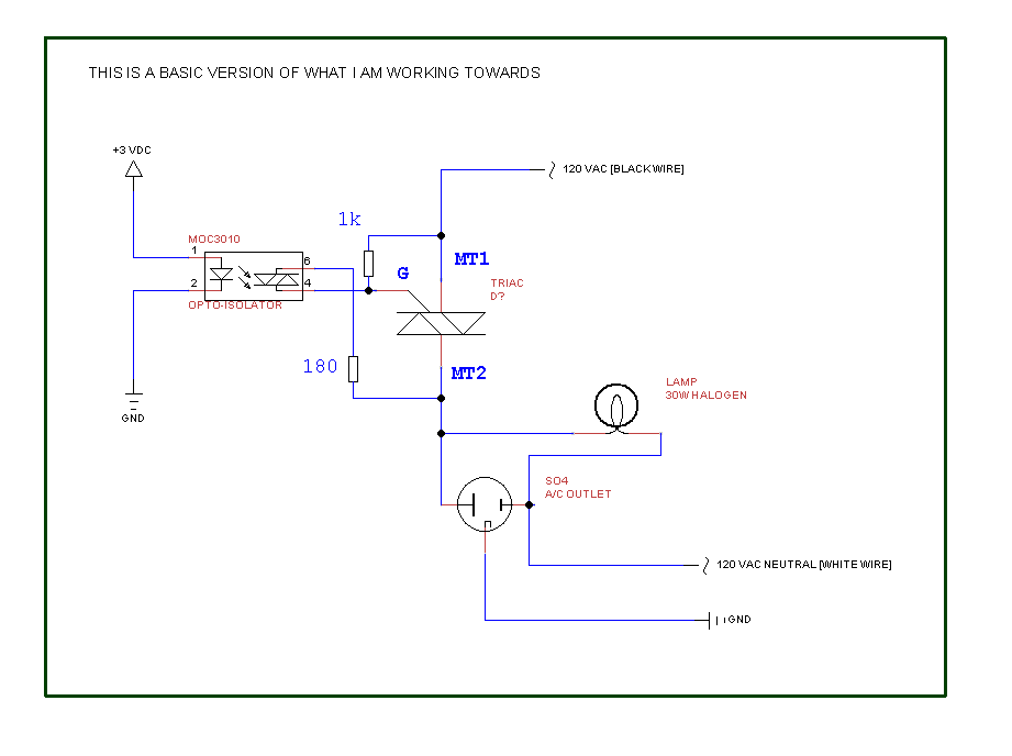

I've attached a drawing of what I was doing. (I think I messed up drawing some of the symbols for the a/c lines)
So now my next step: I am going to try to integrate resistors. As well as increase the load on the TRIAC.

Hi peppy,
You need to read more posts since your last one. You would have found out already that you need two gate resistors...one in series and one in parallel.
Also, your upper connection should be going to the other triac terminal (on the bottom) which is MT2.
So you have three things you have to do to get this working right.
You may also need a capacitor in series with a small value resistor for snubbing MT1 to MT2.
See attached diagram.

Thanks MrAl for your revised drawing - It works great now!
