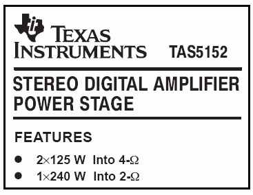

I am required to amplify a PWM audio signal and then filter it to get the audio output. Please help me with the type of MOSFETS to use and the type of MOSFET driver to use.
Why not just use a class-D audio amplifier IC?

Has anyone listened to a class D audio? I have not but I once built a PWM sonar amp, the intermod products were only 6 dB down and I could not use it. I should think it would sound bad, but maybe the ear is not that discerning?
Hi Russ,
I haven't heard TI's 240W class-D amp but since its PWM oscillator operates at 384KHz and its harmonic distortion is between only 0.1% and 0.3% at any output power up to max, I don't think it will produce audible IM distortion. :lol:
