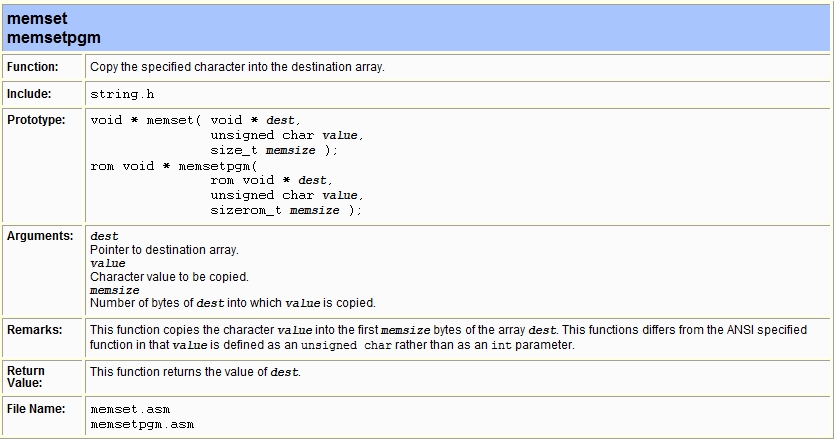

what compiler ? in C18 you can simply use "memset"
im sure memset is in other compilers... .check the manuals...
In your case:
memset(MyArray,0x00,64);
Not sure if its better but it will surely make your code look better with 1 line of code and not 3 for a loop
