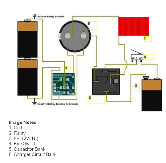

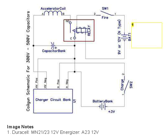

I have recently been making a coilgun in my spare time and have reached a snag. I have no idea where I would put a voltmeter so I would know when to send 350 volts through the coil. Any ideas where?
(THIS IS JUST FOR A SCIENCE PROJECT. I WILL NOT BE USING IT TO CAUSE HARM TO OTHERS)
(Schematics below)
You would measure the high voltage across the high voltage capacitor, but if you don't know enough about electricity to know that, I don't think you should be playing with stuff that can kill you.

Make sure your meter is set properly. Make sure the probes are in the correct areas on the meter. Do the math to be sure the voltage on the caps do not exceed the rating of your meter.
If your meter has a max of 300v, and you are using a flash circuit to charge the caps, they can EASILY get to 400+ volts.

Furthermore, expect the realy to weld shut very quickly.
That will permantly energise the coil (for say 0.1s, until the caps have discharged). This will just pull the projectile into the centre of the coil, sending it nowhere.
