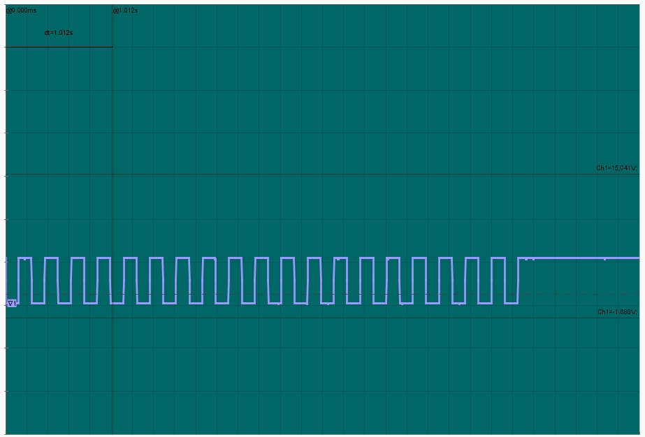

Attached is the output of a 20p coin (20 pulses).
So is all of the above possible with my 16F628A?
Thanks.

As far as I can tell from your picture, the pulses are very slow. It seems to be about 4 pulses per second. You could easily count that with the 16F628. I would run the pulse counting code as 75 Hz as well. I suggest that you use that to time how long the pulse is seen as high, and the how long that it is seen as low. It should be low for at least 50 ms (3 times round the code at 75 Hz) before it is considered low, and similarly for high. When it has been high for more than 250 ms (19 times round the code at 75 Hz) then the pulse stream has stopped, and you can decide what to do with the count.
