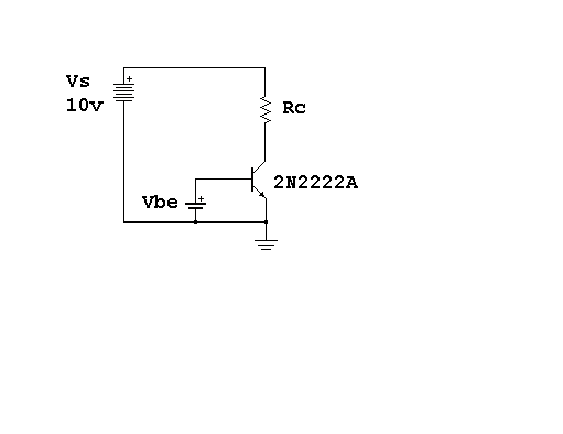

Hello there,
We have a 2N22222A transistor and 1k collector resistor (Rc) and a base emitter voltage (Vbe) of 0.65 volts. This is powered by a 10v supply source Vs. What is the collector current Ic ?
Feel free to use whatever method you care to. In another thread we were talking about using a voltage control method so that's why i stated a base emitter voltage (Vbe) of 0.65 volts. We would like to stay away from Spice for now though, and use that later to check our results.

Hi Al,
I cannot calculate the collector current based on those parameters.:rolleyes:
Eric

Hi there Eric,
Can you tell me why that is? What would you like to see changed?

For starters the transistor hfe and Base current due to the 0.65v voltage on the base pin.

Hello again Eric,
Couldnt the HFE be found from the data sheet?
So how would you change this circuit to make it more 'solvable' ?
If you apply 0.65V to the base-emitter of a transistor then some transistors will have a high base and collector current and maybe will burn out but other transistors will have a low base and collector current because each transistor is different even if they have the same part number.
Also, a transistor conducts more when it is warm and conducts less when it is cool.
Therefore, we feed a current (not a voltage) to the base of a transistor and add an emitter resistor to swamp the difference of Vbe of different transistors.

Hi
I could get the hfe from the datasheet, I could also get an estimate of the Ibase from the d/s plots if they were shown.
To make it more solvable I would calculate and add biassing resistors and perhaps an emitter resistor if I wanted to have a known stage gain.
E
What would you do to make it more 'solvable' ?..:rolleyes:

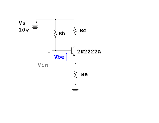

Hello again,
audioguru:
This is more of a theoretical question where we hold certain things constant like the temperature, and ask about the behavior when we look at the base emitter voltage.
Eric and audioguru:

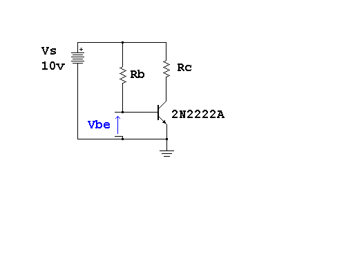

I have attached another circuit, with an added base resistor. Now we are MEASURING Vbe rather than applying it directly. The measured value with Rb=518k is 0.65 volts again. So the base emitter voltage is again 0.65 volts. See if this makes it more simple now. But keep in mind i am not looking for super super accurate numbers here, my main goal is to (possibly) show that using the Beta vs using the "voltage control" is not that much different because the unknowns are still unknowns or rather the knowns are not as well known as they are claimed to be. In fact, i think there is a spread for the voltage control parameters as well as the well known spread of Beta.
So anyway, i would think that this circuit should not throw us 'professionals' in 'electronics' too far, that we should be able to come up with some reasonable result because after all it is just a one transistor circuit right?
Feel free to agree/disagree on any item, we can discuss it in more detail.
Suffice to say, the circuit as drawn is unrealistic and its performance unpredictable.
The Base current will be ~18uA.
Just using the d/s, no equations, for Vbe versus Ic the 2N2222, gives approx 5mA for Vce=10 at 25C.
Also from the d/s using the hFE versus Ic gives an hFE of approx 180, which gives a IC figure of approx 3.2mA
E

You can ignore β in your calculations but that doesn't mean it has no effect on the bias point. The value of β affects the voltage output of the divider bias circuit as determined by the divider equivalent resistance. Variations in β will cause the divider voltage to vary, which will affect the bias point. It may have a small (or negligible) effect, but it does have an effect.
Hi crutschow,
it seems I have expressed myself not clear enough.
Of course, you are right that B (resp beta) has an effect on the bias point. Did I state there would be no influence?
My only intention was to show that the result is a good approximation of the target value for Ic - even in case
* B=infinite (and that is the background for ignoring Ib), and
* Vbe (rough estimation) between 0.65 and 0.7 volts.
This example should demonstrate the immense effect of dc feedback on Ic stability - and is one answer to the question raised in post#5 ("So how would you change this circuit to make it more 'solvable" ?)

Hello again,
Yes the span of B has quite an effect. From the data sheet (or at least one of the data sheets on the 2N2222A) i find that B can go from about 50 to about 300 when we are dealing with collector currents in the range of this circuit. That's because the span of Beta is not specified very well, as well as the variation with current, but even just looking at the manufacturing span we'd have to use that range if we wanted to be sure. And see this goes with any circuit. But lets look at this for a minute.
The input voltage is specified as 0.65 and since we have a 10v power supply that means we have a fixed voltage across the base resistor which means we have a fixed input current of around 18ua.
Now take that 18ua and multiply it by 50 and we get 0.9ma, which is less than 1ma. But take that 18ua and multiply it by 300 and we get 5.4ma, which is a considerably different Ic.
But here's the catch, and whole point of this thread...
The voltage control 'people' would like to say that by using the voltage control method of calculating the collector current is somehow more accurate. But there's no way to ignore Beta regardless how we do it. We dont suddenly loose Beta. It's still part of the transistor operation, or at least a way of looking at it, and it doesnt go away just because we use a formula without Beta in it.
Am i making this point clear now?
Anyway, for those who would like to see an emitter resistor in the circuit i've included that in this next circuit. The values are:
Rc=1k as before,
Re=100 ohms
Rb=497k
Vbe=0.65 as before.
If you would like to throw a few calculations for this circuit in, we can take a look.
