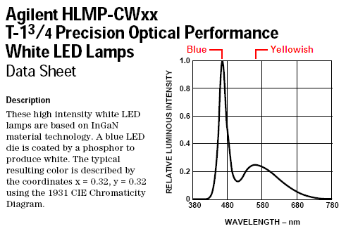

Thats how the world's first white LED was made. It contained a red, green and blue LED chip that made it appear white. After that the true white LED was invented that used an single chip that made white light.
I don't think so. White LEDs are a blue one with a see-through yellowish phosphor.

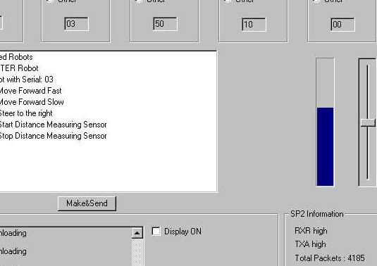

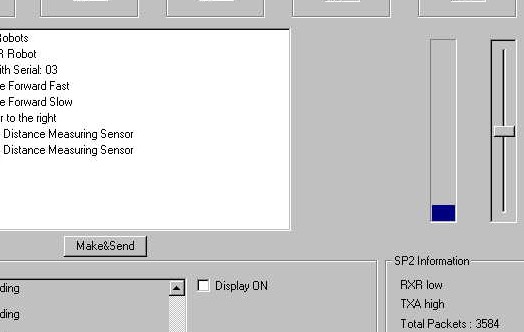

Hello there again. Well my GP2D120 sensor has arrived and i tested it. As we discussed in this thread, i was looking for something to distinguish between two colours. ( or even black or white :roll: )
In the following pictures you see a simple GUI i made on the PC to be able to observe my results ( and control my robots ). Anyway, on the right you can see a blue bar. That blue bar is ROUGHLY a percantage of ~~~ 0 and 3.3 volts (which actually represent the distance). I should also tell you that GP2D120 has filtering to minimize color distorsion of the distance measurement. when i placed the testing object REALLY close to the sensor 1 ~ 1.5 cm away i got the following results. The first one shows the result when i placed a black object, and the second shows the result when i placed a white object.
That means i will be able to do what i initially wanted (distinguish objects) when i place my robot really close to the object.
Well the results are the following:
