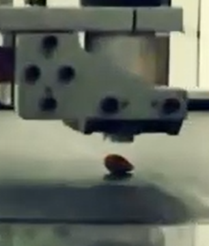

Yep...and the cameras are well before the picker (red arrow) I think.
I was just trying to get a good picture of that area. The light is very bright. There must be a reason. We once used a line camera for a job like this. 100x1 camera. The price of cameras are so low I would use a "normal" camera. Even if the software was set up to do 1000x1 camera I would use a normal camera and just study one line of pixels.
The bright light reminds me of a scanner. I think they could be using several kinds of imaging. It really is pretty cool.
If I am seeing correctly, in the video it looks like they are sucking the bad almonds up through that hose...to be used in something else I suppose.
What do you think that machine costs? Over 100K?
That maybe how they're doing it in that video, what I was trying to say was, that isn't how industry does it, the video your talking about is way too slow, you might as well have a human sitting there doing it. It is more of a 'picker' than a sorter. Look at how the companies making the sorters do it , with air jets at much higher speed.
From the video: (just a still picture)
