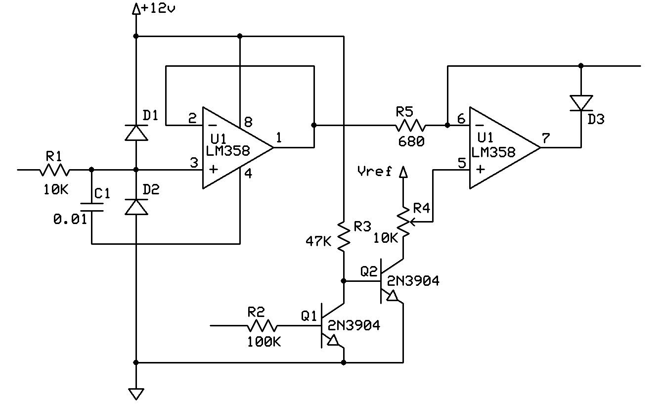

Put a transistor+base resistor or mosfet between the bottom of the 10K pot and ground. Make Vref +5V. With the transistor's input low, the opamp's non-inverting input is at +5V and will limit only above +5v. Higher, if Vref is higher. With the transistor's input high, the opamp's non-onverting input is at +1V (set by 10K pot) and will limit above +1v.
OK, the input logic is opposite of what Tom wanted, but another transistor and resistor would invert that.

Mulling this over, could I not get the logic right by using a PNP transitor at the bottom of the 10k pot to ground, so that a low input to the PNP from my switched control line will complete the voltage divider, clamping the output at the pot setting, while a high input from me switched control line will disconnect the bottom of the pot, creating a clamped limit equal to the undivided Vref of 5v?
A PNP won't work. Two NPNs should give you the correct logic.
Ken

Ok, I did a little breadboarding this morning, focusing on just the original clamp for now. The circuit worked to clamp the voltage as designed, but only down to about 2 volts or so. In my situation, I am trying to clamp the output to about 1vdc. When I set the clamp pot to 1vdc or thereabouts, the output is about 1.4vdc or so. It seems to have this kind of increase unless the clamp is set higher. At 2 or 2.5 volts, the output is virtually identical to the clamp value. Any ideas why that is?
Re-reading some earlier discussion on this, it appears the LM358 cannot output as low as I need. Perhaps I need to find a different chip?

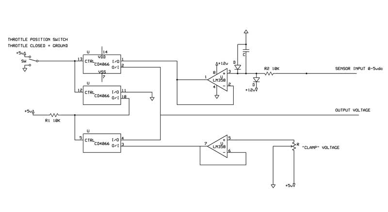

That is correct. I am starting to think it would be easier to have a simple 0=5vdc voltage follower and simply switch the output over to a fixed 1vdc (or other "clamp" value) via a the hef4053 or 4066 circuits when (a) the input exceeds 1vdc AND (b) the throttle/control switch is closed. This was my original thought and the reason for my "throw switch" thread. But will an LM358 follow voltage from 0 to 5vdc with a single +12v power supply?

Well, although I'm a bit confused, my breadboard shows that the LM358 (or 324) wired as a simple voltage follower will indeed follow voltage all the way down to zero. So, seems to me it would be much simpler just to use the straight voltage follower all the time, and use the HEF4052 or 4066 to switch over to a fixed 1vdc voltage anytime my control (throttle) switch is closed AND the input voltage exceeds 1vdc. That way, the output will mirror the input all the time, except when the input exceeds 1vdc with the throttle switch closed (which has been my goal all along)... Sound right?

In the original circuit if you measure the Vsat on pin 7 of the LM358, when the clamp is active, you will read about +0.8V.
If you add this voltage to the Vfwd drop of the diode you will have about +1.5V at the output voltage. As you have already observed.OK.
The last circuit you posted dosn't have a diode in the feedback, so it will just act as a voltage follower. Its output will not switch rapidly ON/OFF, which is what you need to control the 4066 gates.
I'll look thru the remainder of your drawing.
Why do you need to clamp at +1V and how 'sharp' do you want the switching point voltage.?
Looking at the remainder of the 4066 circuit, it has problems.
1. The diode controlling the 2nd half of the LM358 is missing.
This diode is required so that the LM358/2 operates a non symetrical comparator.
2. The 680R output resistor is missing.
This 680R is required as its part of the clamping.
Ideally the 'output' end of the resistor would be clamped at +1V by the diode.
The cathode of the diode is connected to output pin of the LM358/2, which is low when the clamp is operating.
If the LM358/2 did go to true 0V, then the 'output' of the clamp would in effect be the forward voltage drop of the diode, +0.7Vnom.
Without the 680R the output of the LM358/1 would be shorted to 0V via the diode..
The 680R is chosen to be as close to the 'resistance' of a forward biassed diode.
3. The connection from the LM358/1 output to the LM358/2 input is missing, so how are the 'clamp' and Sensor voltages going to be referenced to each other.?
4. If the clamp did operate, the output would be clamped to 0V not +1V.

Thanks for the feedback. You're right, I do have some missing logic in my circuit. I was trying to get away from the LM358 acting as a clamp, since it can't clamp below 2 volts or so. Instead, I was trying to have the circuit switch between the sensor input line and a fixed 1v line based on the input of the throttle switch on pin 13 of the 4066. What I fogot to do, however, is add logic so that it only switches to the 1v line if BOTH the switch is on AND the sensor input is more than 1vdc on pin 1 of the 4066. So, I'll go back and add a voltage comparator to pin 1 of the 4066 and and an AND gate on pin 13 of the 4066, and then see what you think. If that makes any sense...
