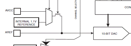

I would not think Vcc would be a very good reference, too much noise, voltage variation over temp. You can supply a external Vref to the Aref pin on one of the headers of the UNO board. The Maxim 6126 is available in 2.048V, 2.500V, 2.800V, 3.000V, 4.096V, and 5.000V output voltages with a +/- .02%
I think the internal 1.1v ref is +/- .1vdc.

I told you a ardunio uno is not made to use the adc as it should be they left out a part. They had this talk about the adc being off from what it should be. The amega uses a TANK CIRCUIT but it's not on there and it has noise canceling built into the atmega the LC tank helps hold AVCC level.
But without it the ADC does not do as good a job. Most people just tie it to vdd and some add a cap. But I have not seen any with the inductor as the data sheet tells you to do.

I am sure the ATmega328 ADC works well when used per the datasheet. The UNO board should be revised to properly use the AREF pin, and have a 2 pin test header as close to the AREF pin as possible. Then again precision may not be the intended use of the UNO?
The atmega has two pins AVCC and AREF. The AVCC is what's used to supply power for normal adc use. The chips has built in noise cancelling. The AVCC is to be tied to to VDD with a 10 uH inductor. And having the ADC supply brought outside the chip lets you have better supply power and have a nice adc ground plane. Shows it in the data sheet.
If you want to use something else you supply that to the AREF pin.

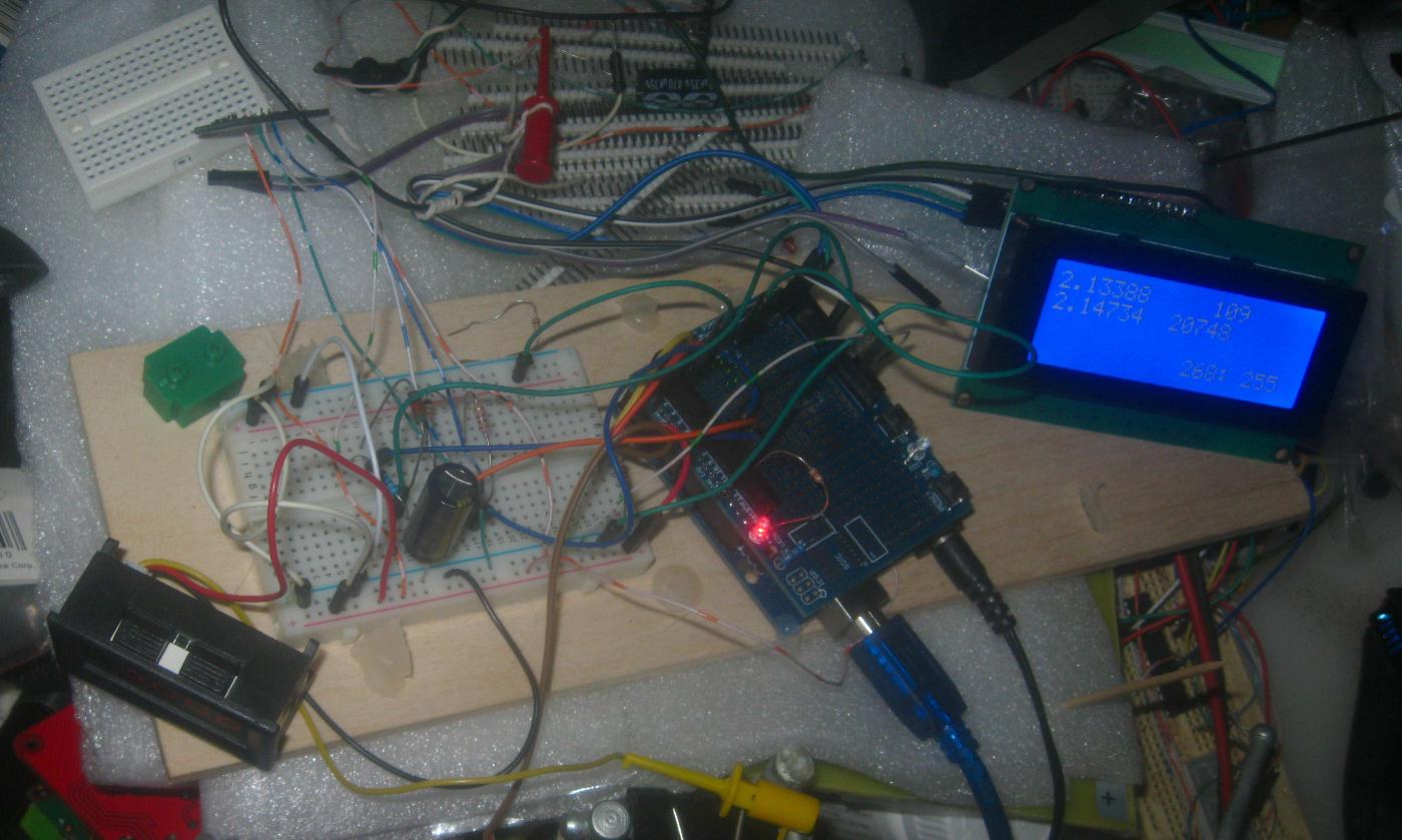

I have found that one of the main problems is the Arduino connectors and the little plug boards that are often used for prototyping. The connection to the plugboard is somewhat variable, so that the reference voltage and/or ground can be changing by as much as 80mv, which is a lot for an analog project. This means the reading will always vary.
To test, i used a 3 point, 4 digit calibration scheme with a second order fit, then compared readings. The readings match one time, then dont match another time. If the power is turned off and then back on, it might read as much as 10mv difference. If the wires are just moved slightly, it might read 20mv difference. Calibrating a second time shows the same behavior, so the main problem is the connections between the 328 chip and the power supply ground and/or +5v line.
So the lesson here is that the plugboards are not any good for serious analog as well as high frequency projects. This little project will have to be all soldered together for better repeatability and proper testing.
An interesting point here is that the plugboard circuit draws very little total current, yet the connections to that board are still important. For example, the filter draws less than 1ma. You would think that would not form much of a voltage drop because even in 1 ohm (which would be high for a short wire and connection) it would only drop 1mv.

Yes i have found that plugging in a "shield" will bend the header pins on the Arduino board so that regular jumpers do not stay in as tightly anymore.
What i did was soldered two wires right to the Ard board itself, one to +5 and one to ground. They run to the plugboard (solderless breadboard).
I think the +5v regulator is solid, it's still the connections on the breadboard that must be causing the problems. I also added what they call a "prototype shield" which helps with the 'used' header problem for clock and data lines. It also breaks out the +5 to five more header pins and five more ground header pins.
I am planning on soldering a few connections later today rather than use the plugboard for everything to see if that helps. I think it will. At least for the +5v and ground, the rest is probably OK in the plug board because it is fairly high impedance stuff.

Here's a quick snapshot of the setup...

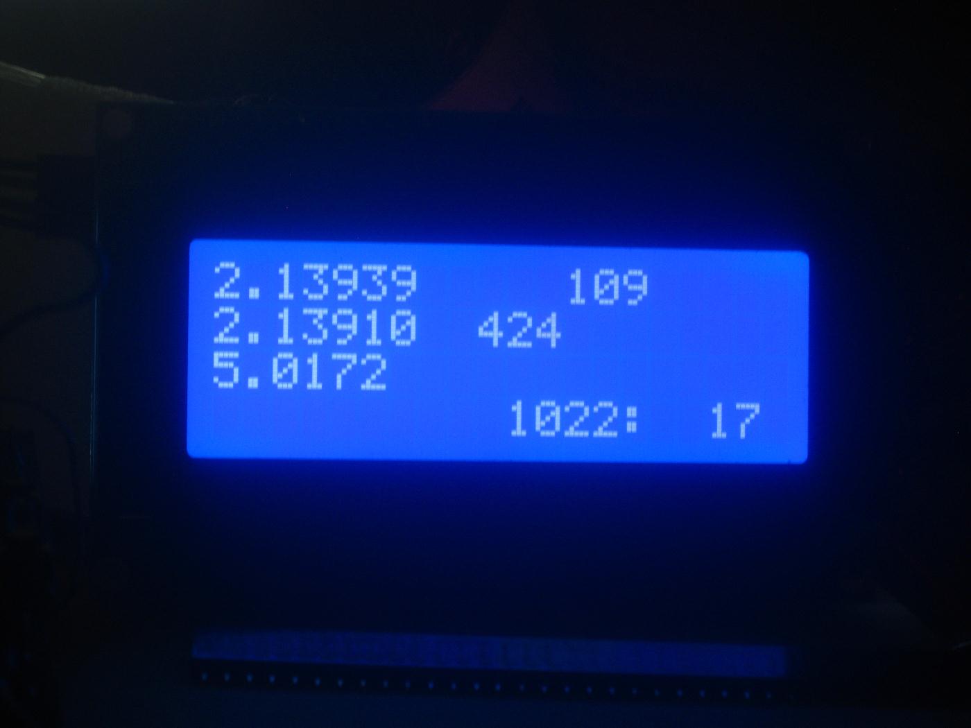

Finally got this thing somewhat calibrated, although i'll have to repeat of course when i move to an actual permanent circuit board.
The top left reading is the 16 bit ADC, the next down is the 328P chip ADC, the next down is the 5v supply line measured against the 1.1v internal reference calibrated with a 4 digit volt meter (wanted to keep track of the 5v line actually getting to the chip itself rather than somewhere off in the distance on another board).
This also had shown me that the breadboard voltage changes up and down by at least 20mv while the Arduino PC board voltage doesnt chance much.
Better results overall however after soldering a ground wire right to the PWM filter cap ground lead. The breadboard connections just were not good enough for whatever reason.

Yes, mV reliability requires solder joints or quality gold plated connectors without jumper vibration.
