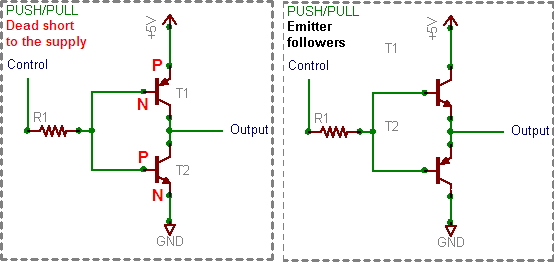

The push-pull transistors won't work because their b-e junctions are forward biased and a dead short to the supply. Then the gain of the transistors will try to amplify the massive base current.
It's not a 'dead' short, it's 'only' two forward biased silicon junctions directly across the supply 8)

Since the transistors have current gain, the current will be higher than that therefore the supply and both transistors would be very dead. :lol:
why would you say its a dead short?
if the control signal is LOW, only the PNP transistor would be conducting, conversely if the control signal is HIGH, only the NPN transistor would be conducting?

Without a control signal input it has two 0.7V forward biased base-emitter junctions shorting the 5V supply down to 1.4V.
If your control signal had lots of current, and managed to go low enough to turn off the NPN then the supply voltage would be dragged down to about 1V through the forward biased base-emitter junction of the PNP.
Similarily, the control signal can't go high enough to turn off the PNP because it is clamped to 0.7V by the forward biased base-emitter junction of the NPN.
I also have it on a breadboard... the transistors are not smoking, they're not even warm, there is no short across my supply, as verified with my ammeter, the current draw is only that of the load connected (my leds)... the circuit is working as intended as far as I can tell.
Impossible. Maybe they are drawn incorrectly. Maybe they are emitter-followers like this:
