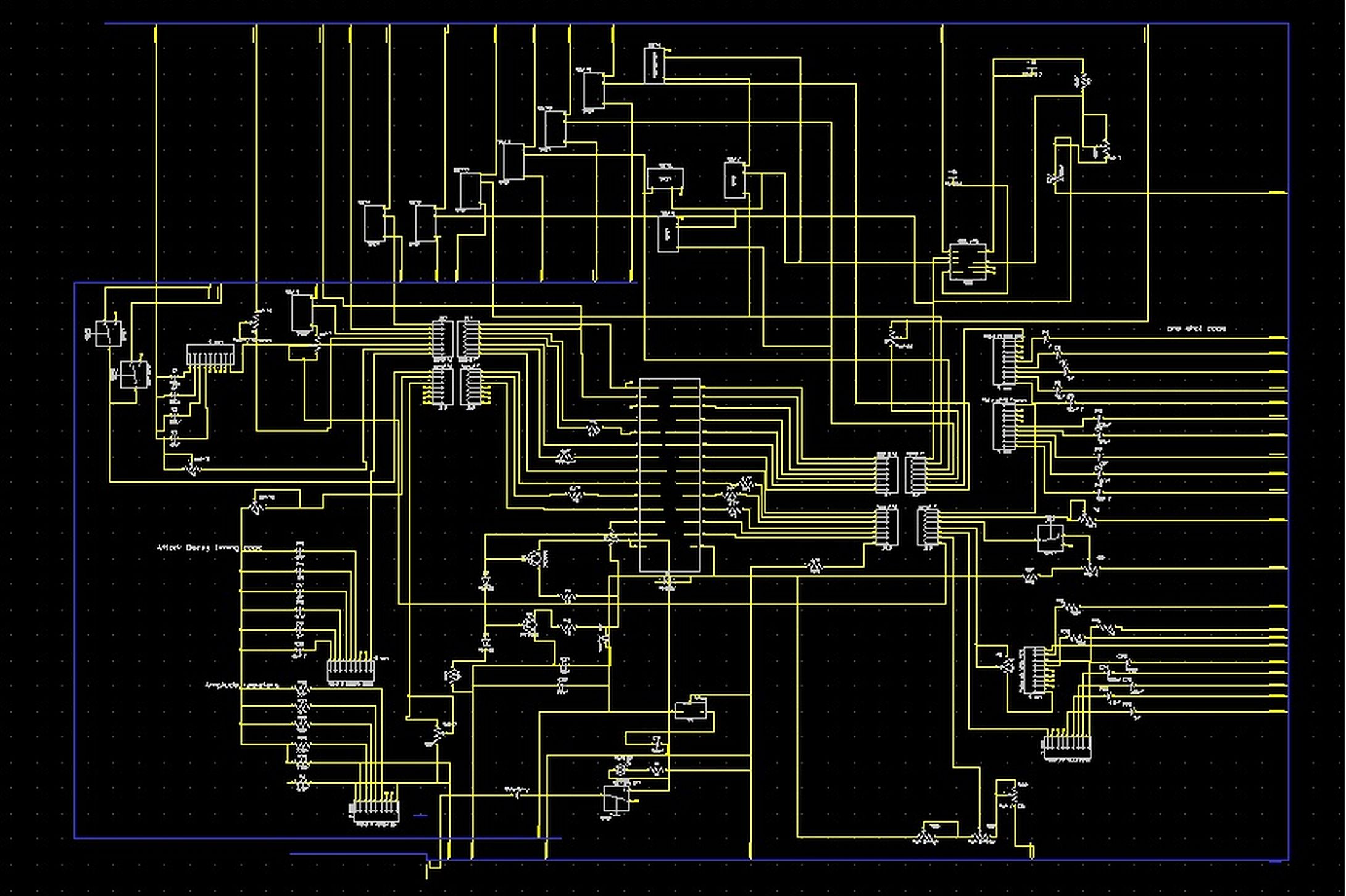

here is the schematic I am actually using with Diptrace. All the switches are SPDT (all the little boxes) for ease of drawing out the schematic. All the switches and rotary switches are to be mounted on a panel as no PCB is needed except maybe to mount all the caps and resistors. Originally had all on same board but a lot more jumper wires so the PCboard is now utilizing ribbon cable. Hopefully people can read this if interested.
I read the sheet after posting hence the edit, I was surprised considering the age of the chip that the data sheet dosnt show resistors! I guess I am used to newer ones, having said that I might see if I can get hold of one of them chips, it would have been useful for the music gun thing I made, the chip kind of strikes me like a bunch of 555 timers in a compact package.
Apparently some thought the pic I posted etc was a dig at you, I hope you took it the way I intended you take it, as a welcome back blah blah blah, also the whitehouse comment was more about you know what than anything :D and hopefully you laughed as much as I intended you too ;). Problem is many dont know what goes on in email etc ;).
NOT that you should change it but I cant see the diagram well on the dark background!! I have glasses now but I find that combination difficult to read, just a heads up.
I know the background needs to be white but still can't read the part numbers etc. Ran into this issue long ago but ? I saved it in png and jpeg but no real difference.

Well here are the compressed files for the schematic and PCboard in Diptrace

Does DipTrace allow printing to a PDF? That is a standard feature of some programs, such as Eagle, and it allows almost everyone to see them without installing DipTrace.
John
I remember a long thread on your woes with dip trace and getting a clear picture, if you have it doing a clear pic then leave it alone :D, I think the ones you have were less common but are more common now.
Yes I remember but don't recall getting a clear pic. I think I had to change the font on all the parts?
And no I don't see a pdf export.
