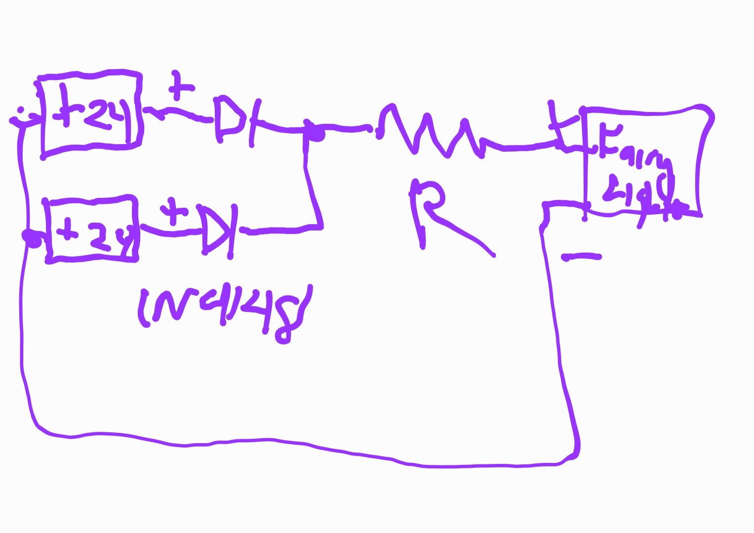

I have a simple LED strip light setup as shown in the pic. the source is a trigger / switch from a accessory output port, so no issues on that end.
I need help with this:
1- Is there is suitable IC chip for this job?
2- I need to place a diode in there somewhere to keep juice from flowing backwards to the other source. Where do I place it? (yes Im fairly new to this stuff.)

ps. I also recommend Ron's single-regulator system configuration in post #3. It eliminates the need for Shottkey diodes, costs a lot less, and is just plain less work.
Because of omitted information in the original question, the KEY piece has been missed here.
The load being powered is a fairy string of LEDs, originally powered by a pair of 2032 coin cells. This diagram shows the fairy string – a number of LEDs in parallel, possibly a current-limiting resistor and a battery. The resistor may not be fitted, depending on the high internal resistance of 2032 cells to limit current.
For calculations, this can be reduced to a basic LED circuit as shown. The necessary parameters are:

The source voltage can be 24 volts, no need to regulate it down.
Vf depends on the color of the LEDs. Red is around 2 volts, white around 3.7 volts.
For parallel LEDs, the current is calculated from the desired current per LED × the number of LEDs. But we can take a shortcut here. 2032 batteries supply at most 20mA for any length of time. Start with a resistor calculated to deliver 10mA. If that's not bright enough, calculate for 20mA.
Using Ohm's Law,
R = (Vs -Vf)/I
To supply 10mA to white LEDs from a 24 volt supply:
R = (24 – 3.7) / 0.010 AMPS
R ~ 2k ohms
Power dissipated in the resistor:
Pd = I^2 R = 0.01^2 × 2000 = 0.200 watts.
Use a ½ watt resistor, near 2k ohms.
Use two diodes as discussed to isolate the supplies. Save the voltage regulator for another project.

Geez. It's a meter of tiny "fairy light" LEDs designed to run from two 2032 cells. Fixed load of at most 20mA. Why complicate the circuit?
Two diodes, which could be as small as 1N4148s or any of the 1N400x series. One resistor. Worst case dissipation of the resistor is less than ½ watt at 20mA, ¼ watt at 10mA. Three parts. Three simple connections and done.

Yes. This is what I attempted to explain (poorly I guess) in post #31. You must drive LEDs through a series current resistor. They fairy string light could only draw around 20mA maximum from CR2032 batteries. Doing what you're doing is ROOSTING the fairy light string. Please try to understand my explanation in post #31.
The circuit you need is exactly shown here. Between your power supplies and fairy lights, you need:
● Two diodes. Rated for 50+ PIV. Whatever you have should be fine. 1N4148 would be a compact choice.
● One 1 watt resistor – try around 2k to start to supply the fairy light string about 10mA. If that's too dim, reduce to 1k.
With the circuit shown (3 components total) and a resistor value of 1k – 2k, the fairy light string will be operating just as it did originally with the battery supply.

Got a 1w resistor kit, heres the results
At 1.5K Ω it was drawing 0.02A, resistor got hot, LED lights were a bit dim (same as with the battery).
At 220Ω it was drawing 0.10A, LED lights nice and bright and remained cool but resistor got very hot and discolored/burned on the outside.
I would like to run the LED lights at around 0.10A, and because the circuit assembly will be in a confined space with very little air flow /Cooling, what can be done to reduce how hot the resistor gets?
I would assume a different wattage resistor is what I need, correct? What wattage should I get?
