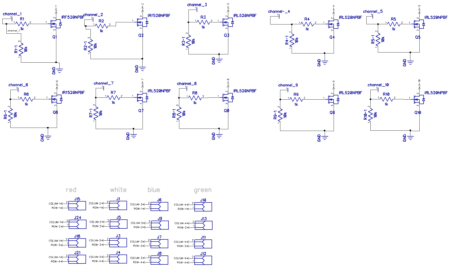

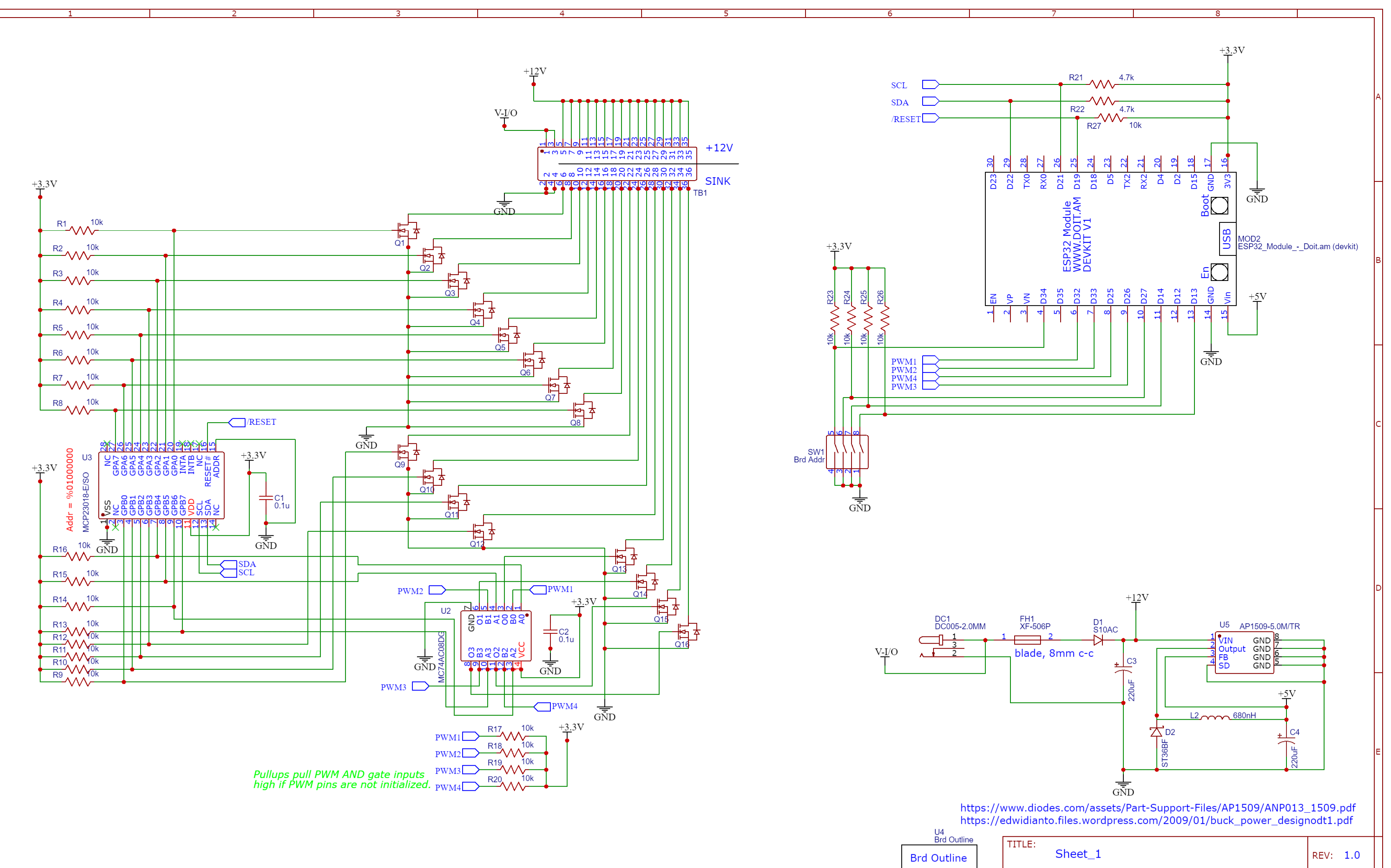

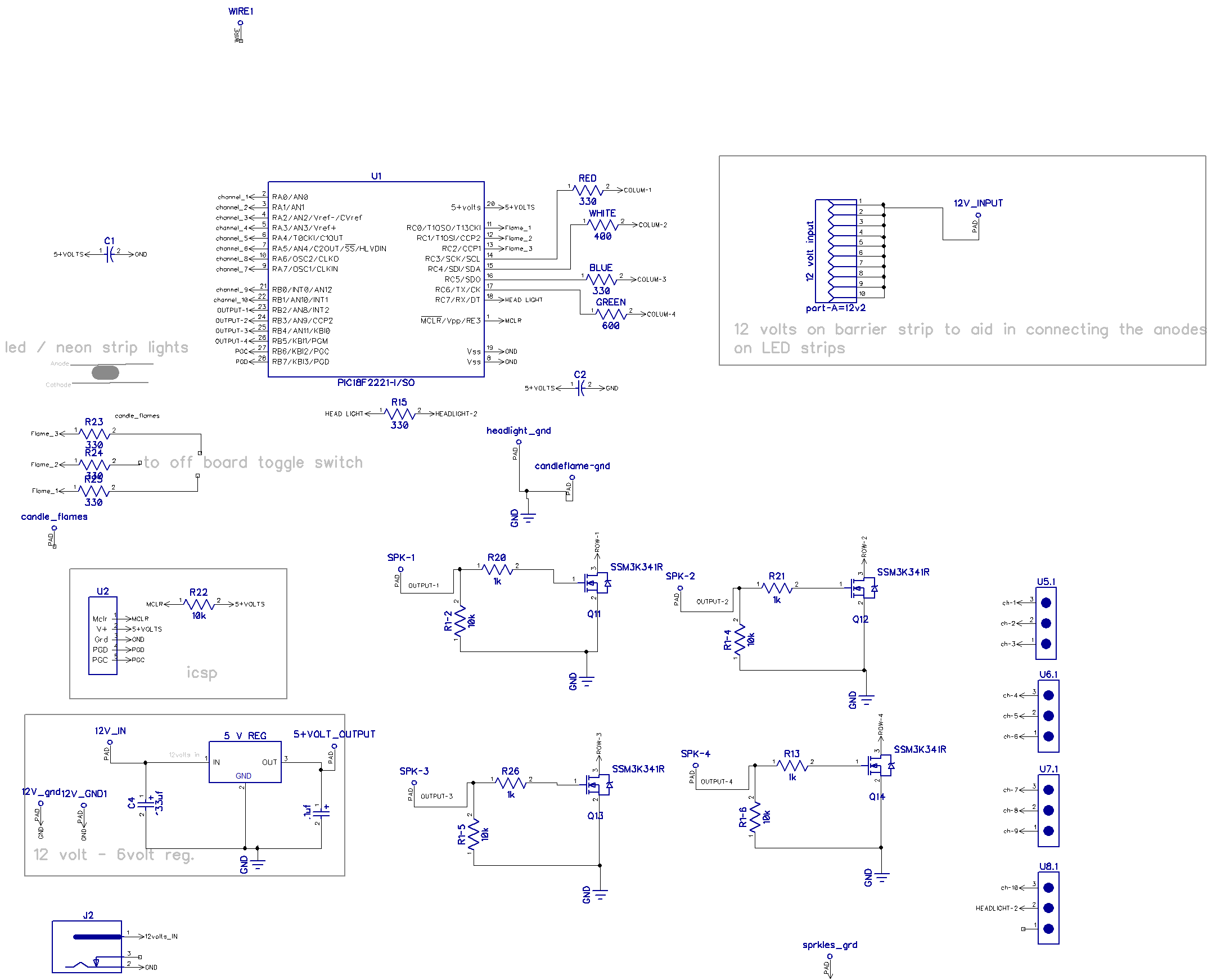

Until you can draw and post a clear, readable schematic (showing all connections) that accurately represents the actual pcb, I think the pool of people willing to help you is zero.
Endlessly posting random code with comments of "it didn't work but now it does" without any explanation and changing directions so rapidly that it's a total mystery what you're doing doesn't help either.
The schematic is readable but maybe I need to post it differently than a screen shot
No, it is not. It's impossible to tell what's connected where without extraordinary effort. Take my comments above as helpful advice or ignore them.

using SF is it possible to enable a weak pull-up on one portB.1
I need to reconfigure portb.1 as an input.
if not then I need to add a jumper wire to port B.1 along with a pull-up resistor
Gee, I wonder if the datasheet has any info on this?
Each of the PORTB pins has a weak internal pull-up.
A single control bit can turn on all the pull-ups.
This is performed by clearing bit, RBPU(INTCON2<7>).
The weak pull-up is automatically turned off when the port
pin is configured as an output. The pull-ups are
disabled on a Power-on Reset.
So, on the 18F2221 when you turn on the PORTB pullups it's on for
the entire port, not just PORTB.1
// turn on 18F2221 PORTB pullups
INTCON2.7 = 0
is there a specific order to set the outputs and inputs?
portB.1 (flames) has a pull-up resistor (verified) but portB.1 acts like its always HIGH (VERIFIED )
THINKING the order the LATB setting or the TRISB setting. Using the RED, GREEN and Rows to indicate when portB goes LOW.

You need to set the port IO mode to digital since they default to analog. If they are left in analog mode then a port will always read as a '0'.
To do this you have two choices:
- include "setdigitalio.bas" and add a call to SetAllDigital() at the start of your program, like
SetAllDigital()       // set ports to digital mode
or let the compiler do it for you automatically by setting the #option, which must appear before the 'include' statement
#option DIGITALIO_INIT = true     // tell compiler to automatically call SetAllDigital
Unlike the intosc.bas module, SF doesn't do this automatically when you include setdigitalio as this feature was added later and it would change the way existing programs worked.
