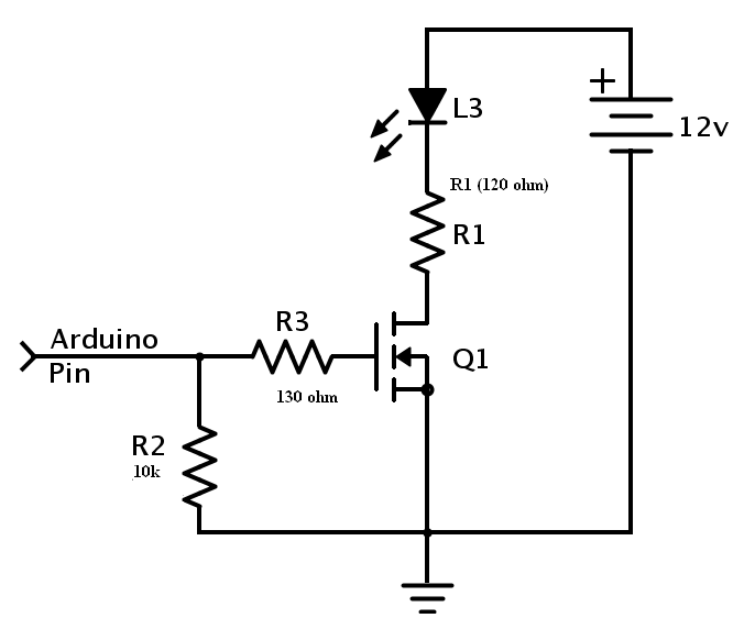

I connected as per #58 but I have no resistors and the GATE has no connection. NOTE the tab is connected internally to the Drain (#2). By touching the tab with the 5v the LED comes ON. Disconnect and led turns OFF.
I would think the tab is connected to the SOURCE(#3)? so it can be grounderd to a common ground
Something is haywire??
If you have no connection to the gate, why do you expect anything to happen?
Sorry, in post #58, I assumed you had the tiniest understanding of a mosfet switch and the smallest ability to read a schematic. The GATE is connected to +5v to turn the mosfet on.
the LED comes ON when I touch the DRAIN or the tab. NOTE if I touch the GATE nothing happens.
Using Post #58 as an example but with no connection to GATE. Connect to GATE (5v)nothing..
YES I can read a schematic and YES I have a basic knowledge of Mosfets as a switch.

Sorry. I can't help. There are 5 connections to make, and it has to work. Either these connections are wrong, or your parts are bogus.
Have you actually READ the part number on the DEVICE? Jameco does not have a reputation of selling bogus parts but shipping the wrong part can happen.
Normally the TAB on a TO220 is connected to the middle pin, so in this case it's the DRAIN (pin 2).
If you have it connected as per #58 and put 5V on the TAB you're connecting 7V across the LED (12V - 5V), so it'll probably turn on but be dimmer than normal.
Well I got it working.
it NEEDED the resistors.
Without the resistors, the led strip comes on just by touching the GATE pin.
IMO the 10k resistor pulls the GATE low.
Now I can finalize my PCB design and order boards.

For an n-channel mosfet, when the gate is at source voltage (i.e., ground), the mosfet is OFF. When the gate is a few volts different than source (i.e., > +4v), the mosfet is ON.
When the gate is connected to a micro port pin (configured as an output), it will either be low (OFF) or high (ON). Therefore, it will work as expected without the pull down resistor.
With the gate floating (i.e., not connected anywhere), touching it may bring it positive enough to turn the mosfet on. If the gate is floating (something you don't want), the pull down resistor keeps the mosfet off. Twenty posts ago, you started with "the mosfet won't turn on", so may this is ¿progress? Ten minutes of research to understand all of this would have saved 4 days of frustration.

I'm not sure what that means, but if you're using the IRF520 then make sure the resistive divider gives you >4V on the gate when the uC outputs a logic 1 (small series resistor + much larger pulldown resistor).
The IRL520 shown on your original schematic is much more forgiving and would work with lower levels (>2V)

It works as planned with the 320 ohm resistor on the gate. It shows 4.02 volts
and yes the MOSFETs are IRF520
Doing some browsing and found this.
The resistor voltage divider has little affect if the gate resistor (130 ohm) is connected AFTER the 10k resistor connection

Well, those two resistors don't form a voltage divider do they?
I wish I had used the IRL520 but .
Doing a simulation using TINA I see about .10 volt increase in GATE voltage using the diagram in post#75
This might be why the MOSFET failed to turn on in my first attempt. Using a different battery pack. The final design uses a 7805 for Vcc

I'm assuming that says 0.1V which is much less than any tolerance.
Maybe it's point ten volts which is 10 times bigger than point one volts.
