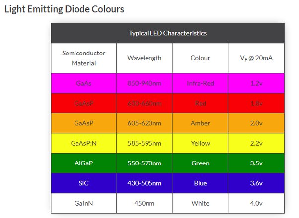

LED forward voltage depends on the chemistry of the LED. Typical values are:
Red: 1.8 volts
Green: 3.5 volts
Blue: 3.6 volts
White: 4 volts
Counting on my fingers, that makes the forward voltage of the string 12.9 volts. Ain't gonna work.
Just use one resistor per LED, the values of which should be determined by adjusting them until the LEDs appear to have uniform brightness.
Note: the chart below is very simplified and does not include the many different chemistries for colors. It covers commonly used LEDs.

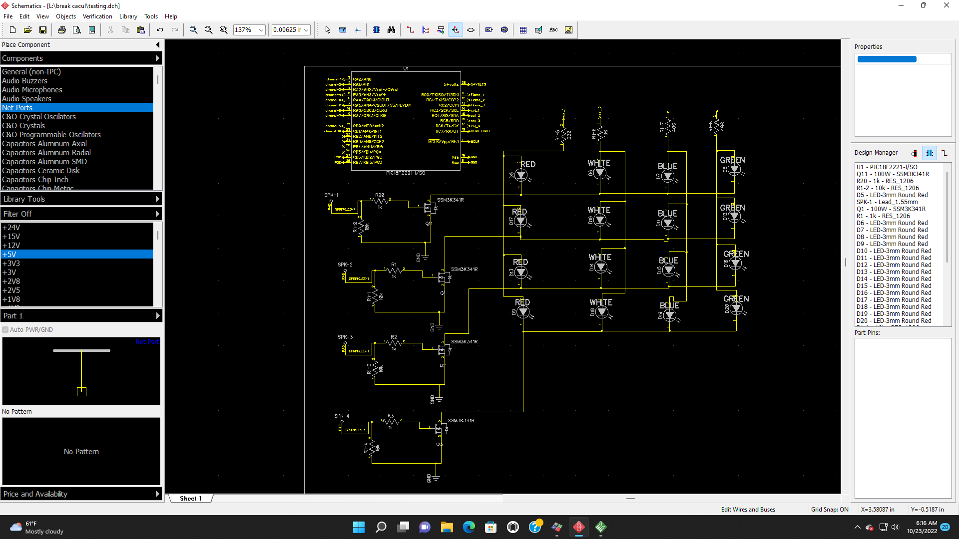

Crazy idea, but seeing how I have 16 LEDs of 4 different colors plus I have a multitude of smd mosfets but knowing turning on several LEDs in parallel is not a god idea. Thinking a 4 x 4 matrix idea, then turning on indivuial LEDs.

If they're connected as a matrix with similar colours in similar rows (or columns) then the on time could be varied to balance the brightness. Just a (random) thought.
That would work of course, but then there's the problem of code to make it work and high-side drivers someplace.
I have numerious unused pins on the pic.
Have the anodes of each color in one of 4 rows. Can adjust brigtness using different resistor values.
Will not have any parallel resistor/led combos
This might work?

Thought questions for your "matrix design":
□ How many LEDs can be on at a time?
□ How much current can a PIC18 pin SOURCE? (how much can you get at +5v?)
□ How much current can a PIC18 pin SINK?
(how much current can it carry to ground?)
Maybe if you think it through, you'll be able to eliminate some parts.....and maybe buy each LED its own resistor with the savings. (0805 resistors are one cent a piece).
4 leds at one time (one of each color)
Vss = 300ma max
sink or source per pin = 25ma
not to worried about brightness. Going to look in my supply of resistors and compare using values close to post#136
Also need to test how much current the Mosfet section draw.
The matrix idea saves several resistor arrays.
