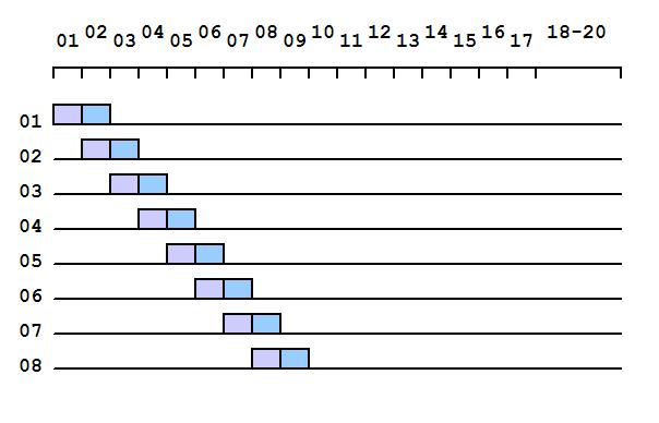

The pic is going to be doing nothing else but driving the servos, a dedicated servo controller. My original idea was to drive the servos sequentially like you mentioned but wont this cause a problems if all 16 servos take 2ms pulses? Right now I have the 1-2ms pulses being sent every 20ms. This works fine for one servo but 16 *could* cause a 36ms period.
Nigel's idea of consecutive/sequential time delay functions is incredibly clever and intuitive. Simply execute 16 consecutive 1-msec time delays, one for each of your PWM outputs, then delay for an additional 4-msecs before starting over. Way to go Nigel. Staggering the 1 to 2-msec processing for each output is simple, elegant, and insightful.
PWM output 01 -- 1-msec total time
Turn output 01 on for #01's "on-delay" time
Turn output 01 off and delay for (1-msec minus #01's "on-time")
PWM output 02 -- 1-msec total time
Turn output 02 on for #02's "on-delay" time
Turn output 02 off and delay for (1-msec minus #02's "on-time")
PWM output 16 -- 1-msec total time
Turn output 16 on for #16's "on-delay" time
Turn output 16 off and delay for (1-msec minus #16's "on-time")
PWM output last -- 4-msec total time
Simply delay for 4-msecs and start over
Regards, Mike
Oops. I goofed on that flow chart. I forgot about the minimum 1-msec on-time. Back to the drawing board for a new flow chart (grin).

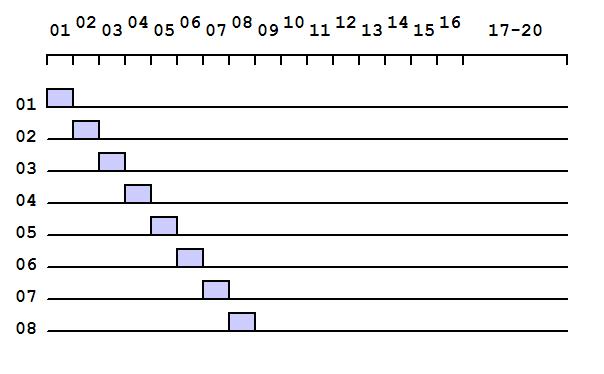

How about this? Is this doable guys?
Period 01 (1-msec total)
Turn on Output 01 (on for entire 1-msec)
Delay 1-msec
Period 02 (1-msec total)
Turn on Output 02 (on for entire 1-msec)
Delay (Output 01 "on-time" minus 1-msec), turn off output 01
Delay (2-msecs minus Output 01 "on-time")
Period 03 (1-msec total)
Turn on Output 03 (on for entire 1-msec)
Delay (Output 02 "on-time" minus 1-msec), turn off output 02
Delay (2-msecs minus Output 02 "on-time")
Period 16 (1-msec total)
Turn on Output 16 (on for entire 1-msec)
Delay (Output 15 "on-time" minus 1-msec), turn off output 15
Delay (2-msecs minus Output 15 "on-time")
Period 17 (1-msec total)
Delay (Output 16 "on-time" minus 1-msec), turn off output 16
Delay (2-msecs minus Output 16 "on-time")
Period 18-20 (3-msecs total)
Delay 3-msecs and start over
Mike,
That would work, but a hobby servos can pulse up to 2ms, making a total period of 36ms (if all servos were to pulse at 2ms). Id like to keep the 20ms period if at all possible. It seemed like the servos had more holding power at a 20ms period versus a 50ms period for example.
If I wanted to use this method and retain the 20ms period it seems like I could only control a max of 10 servos with this method.
Ah, you beat me to it....
Hopefully you've gone back and seen my addition. 16 Staggered and overlapping outputs that use 17-msecs of the overall repeating 20-msec period.
I'm not familiar with C but I suspect that code would work very well in a while procedure, wouldn't it? Period 01 and period 17 would be handled differently with a final 3-msec delay before repeating.
Mike
