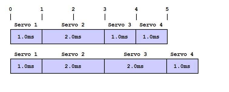

Mike said:
What happens if Servo 03 on-time changes? Wouldn't that affect time between pulses for Servo 04 through 08 during one sequencial cycle?
Mike
The ISR should be doing relative scheduling - set the new deadline for the next pulse relative to the old one. The ISR should only be looking at the pulse width of the servo it's currently pulsing, there's no need to go through all the other pulse times.

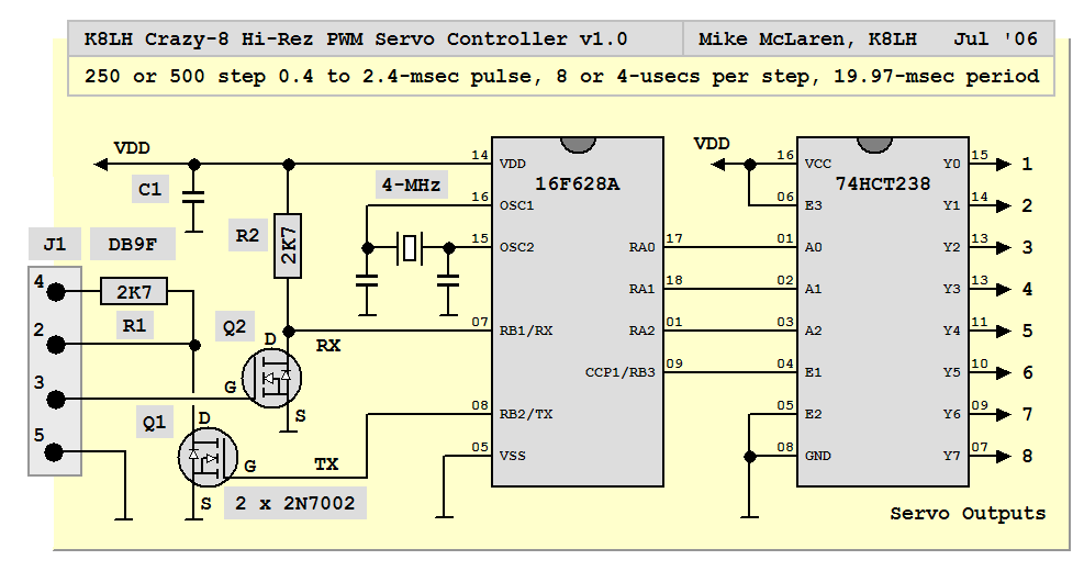

I was thinking of using a tiny 12F683 and an old monster 2764 EPROM (beauty and the beast, grin) but I don't even have a Servo here on the Lab bench to play with so this has really more of a mental exercise than anything else.
mikes-crazy-hi-rez-servo-12f683-jpg.8777
Your solution and perspective is appreciated. Thank you Sir.
James
I mean the time between the start of Servo 04 on-time from one cycle to the next if Servo 03 on-time changes? If Servo 03 on-time changes from 1.0-msecs to 2.0-msecs it pushes the overall period for Servo 04 from 20-msecs to 21-msecs from the previous cycle.

Okay, I see what you're getting at.
If we look at the last servo in a set and and we say that all the servo's are sitting at 1msec pulse widths, and on the next frame we suddenly increas all the pulse widths to 2msec, the last (say 8th one) will end up having a 20 + 7 msec gap between pulses. If we then decrease all the pulse widths back to 1msec, then the 8th servo will end up having a 20-7msec gap between pulses.
So yeah, there will be a pulse gap variation - but as long as the servo is happy with a worst-case 27msec update period, everything should still be okay. Plus this is definitely worst-case since suddenly railing servo's isn't exactly a useful thing to be doing a first place.
BTW Mike, you're posting your graphics as large, low quality, JPG's, if you use GIF or PNG they will be much smaller and perfect quality. You should only use JPG for photo's.
So it seems that 20-msec overall period isn't nearly as important or critical as the pulse width. Cool. Thanks for explaining.

I have an idea, but a bit more info on how you want to control the servos, i.e. rs232 etc and the correct timings would be good.
James,
Just got a chance to look at the 'HCT238 Data Sheet and you're right. It's a perfect match for modulating one of the eight output lines with a PWM signal driving E1.
Thank you for the tip. My Crazy-8 PWM Servo controller concept just got a whole lot smaller by dumping that clumsy EPROM in favor of an 'HCT238. Cool!
Regards, Mike
Nigel,
I apologize for wasting server space. I just figured out why my PNG graphics were larger than JPG graphics. I was saving them from JPG to PNG. When I load the original graphics and save them immediately as PNG they're half the size of the JPG files.
crazy-8-servo-controller-v1-png.8795
I suspect a 12F683 Servo controller with a bit-banged 1200 or 2400 baud serial interface might be somewhat limiting. An 'F628A or an 'F88 with built-in serial port is probably a better choice with the option of implementing the crystal oscillator if needed for stability.
Here's the ISR "engine" with comments to help you understand the concept. So, would this work guys? Is it worth the extra chip?
