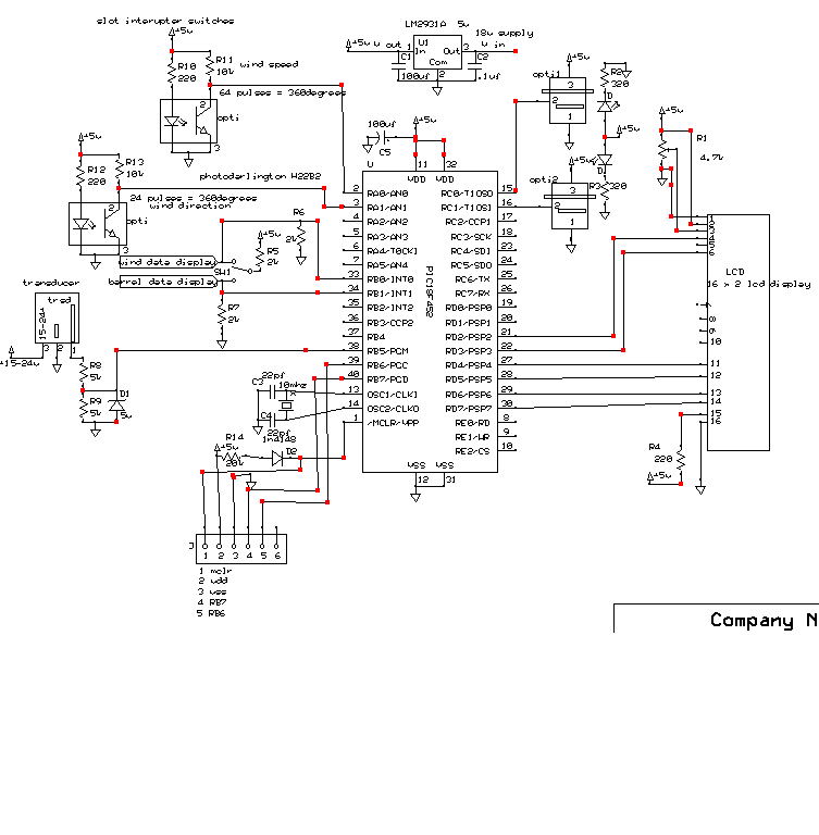

connecting 24v transducer to PIC
Deb.
PIC impedance is not 2.5k.
The maximum recomended 2.5k analog voltage supply exists because of the Sample And Hold capacitor. If the impedance is too high, this capacitor will take too long to charge.

latest schematic
wonder if I need to de-bounce the selector switch?
any suggestions?
