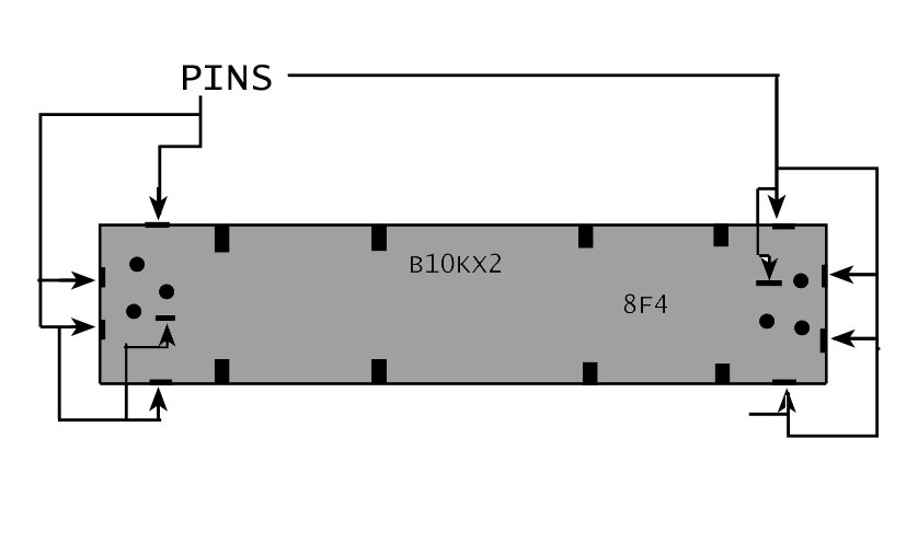

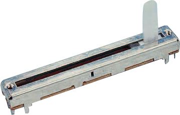

I've also bought 2 "Miniature Dual Gang Linear Potentiometers" at values 10k and 100k, but when i wire it up the moving slide switch has no obvious effect. Please see attachment for images. If there's a specific way to wire this bad boy up, or if its a wrong component can someone say because i know there's other types of potentiometers.
